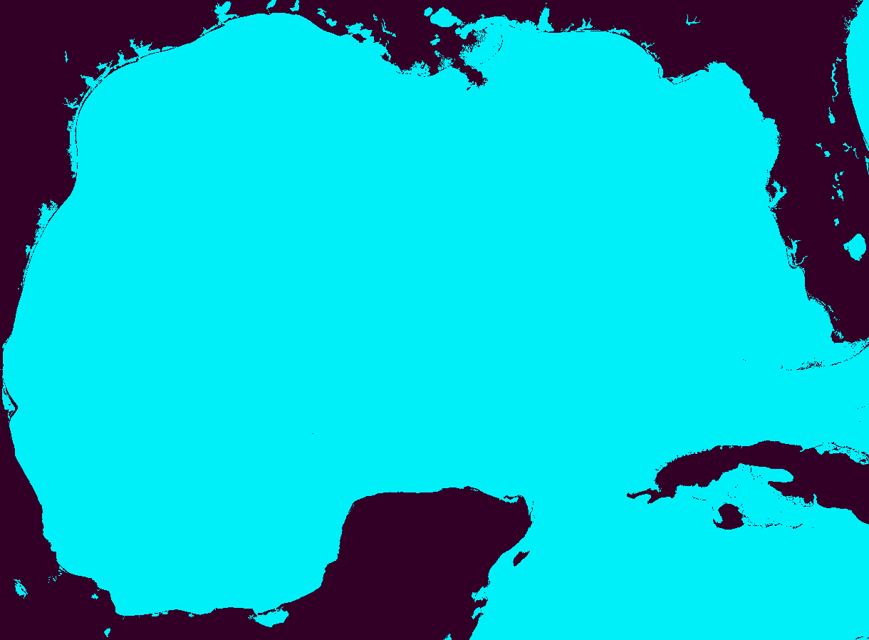

Here is an example: raw land mask for 1.5km Gulf of Mexico model,
1220 x 898 grid points, straight after gshhs_to_roms_mask roms_grid_file.nc
command
The same mask, single_connect -s 500 500 roms_grid_file.nc
green areas corresponds to the original land generated by gshhs_to_roms_mask,
yellow-orange areas are the ones blocked by single_connect for the reason that there
is no water passage to these points from the user-specified point i=500, j=500 designated
as "water"; and dark-brown points scattered here and there on the coastline are blocked for
the reason that they are identified as "narrow bays".
Argument -s stands for show, meaning that each point changed from water to land is set
to -1 or -2 instead of 0, so it is possible to visualize what is is doing. All the images presented
here are just screen captures from ncview. Once processed by single_connect, it is guaranteed
that all the blue area is mathematically a single-connected domain. Once you decide that
you are happy with your land mask and do not want to change anything any more, the next
operator commit_rmask grid_file.nc will set all the colored points to "land", and your model
is ready to run.
