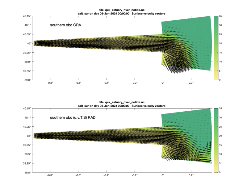

For example, I am working right now with a simple idealized estuary for a class I am teaching. In the case plotted below, a river plume exits the estuary, turns right, and tries to flow out the open boundary. In both plots the 2D OBC are Chapman/Flather.
But in the top panel u,v,T,S have Gradient conditions on the "southern" boundary, while in the bottom panel the 3-D variables are Radiation. With radiation the outflow is impeded and partially wraps up into the domain.
I think of Gradient conditions as effectively setting the outflow phase speed to delta-y/delta-t because it propagates the solution exactly one grid cell. Maybe this is what you want.

wilkin wrote: Mon Mar 11, 2024 6:03 pm Clamping and nudging won't help you if you have an advection dominated outflow because the exterior conditions know nothing of the interior solution that is propagating out along characteristics of the current. They will act as a wall.
You might be better off simply using gradient conditions, which extrapolate what is reaching the boundary one more grid cell to the perimeter.
Oh, thank you very much! I'm also working with the estuary dominated region and these results seem very helpful! It looks like my hypothesis about clamped condition is not good.
Based on these figures, It looks really good. What do you use on the northern boundary for 3D variables then? Also gradient condition? Do you have any inflow from the north or east?
