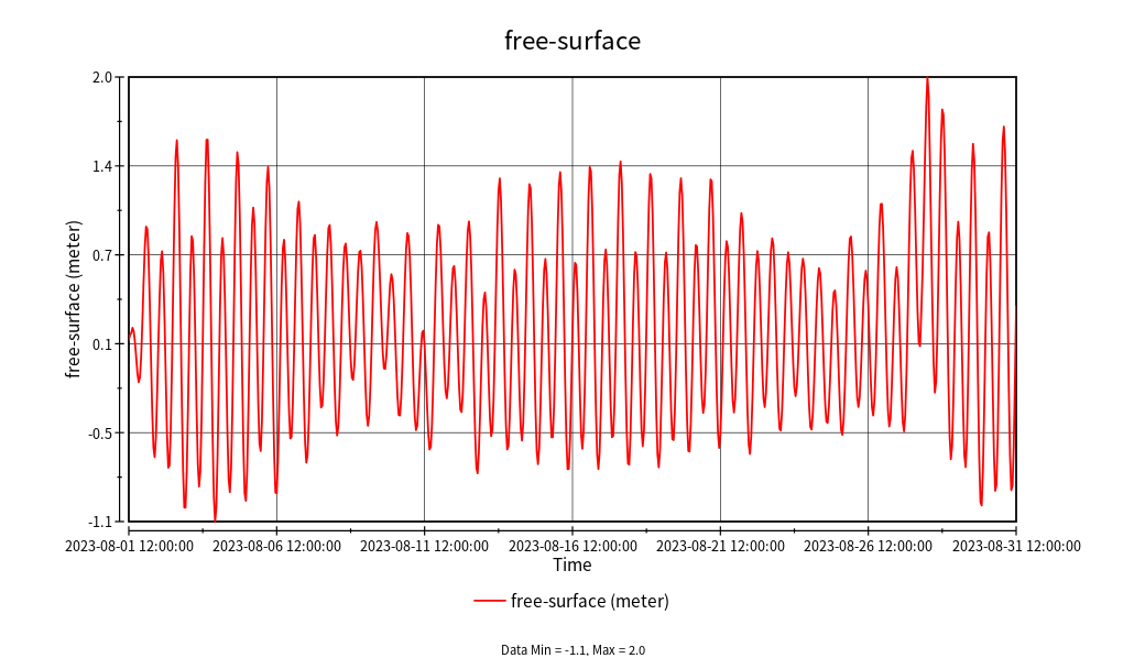

Hello everyone,
I've come across something strange.
My project is mostly modified from the demo example upwelling.
Also the bry, clm, and ini files are all made from pyroms.
Based on upwelling, I modified the grid data and added bulk forcing and tide forcing.
However, I found that the results of the run seem to be very different from the measured data.
Firstly, the tide level data, i.e. the zeta trend is very wrong.
And secondly, the current is particularly strong with the wind.
I see in the GitHub-myroms description that myroms has now implemented wave effects on the currents, and I wonder if this is the reason why my current velocities are unusually large in the presence of wind, but it is impractical to show such large velocities.
I put the same bry, clm, ini files as above into croco mode and ran them, and it turns out that the croco mode arithmetic is not that far off from reality.
So why am I not getting relatively accurate data in roms?

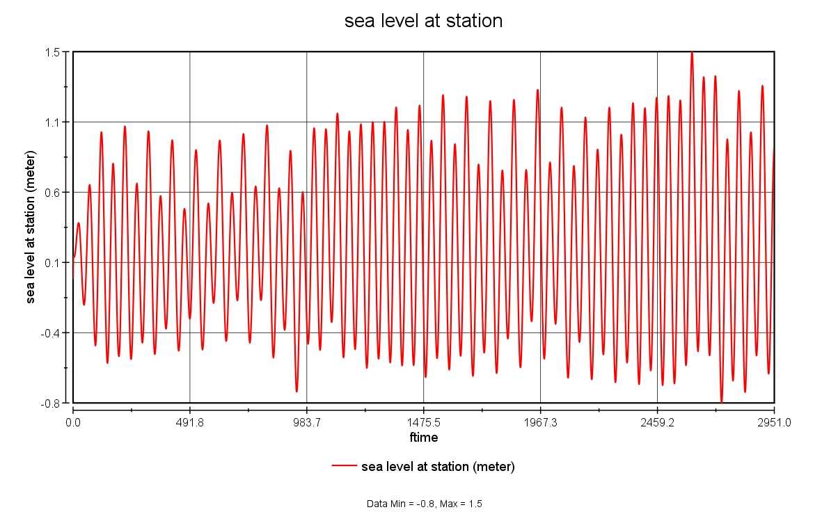

Re: wind -current- Zeta, Inaccurate simulation results
These are the results from the croco mode run
You've got a bit of a mess of CPP directives there.
You have BODYFORCE to add the wind stress directly into the surface layers, but you also have GLS_MIXING and BULK_FLUXES to add the stress at a surface bojundary condition to vertical mixing. Without digging into the code I don't know which you will get. Maybe both.
Look at your log file output closely ... it tells you want ROMS actually did as opposed to what you think you asked it to do. ROMS will reconcile some conflicting options but possibly not in ways you anticipated.
You also have FSOBC_REDUCED but also UV_TIDES. So, I'm not sure what velocity information will be imposed at the perimeter.
I recommend you think carefully on what physical oceanographic setting you want to model, and then methodically go through the options in the template cppdefs.h file and activate a self-consistent set of options. Some flags you have, like MPDATA, are no longer used.
You have CPP flags in there I don't recognize from myroms.org .... OBC_NUDGING, CORE_FORCING, ALBEDO_CLOUD ... etc.
If this is COAWST or CROCO I suggest you post your query on those forums.
I'm sorry that these cpp options are confusing you, these cpp options are my references to projects that others on this forum have posted and discussed.
Even when I deleted them, it didn't change my results that much.
This is what I got using my original h-file and then arithmetic.
At the same time, I also discovered a strange phenomenon. Further offshore, the tide level at this point seems to be somewhat normal. But closer to the shore, the sea surface height is a bit strange, and it seems that seawater accumulation has occurred.
The sea surface height shown in this picture is far away from the coast, while the sea surface height shown in the above pictures is relatively close to the coast.
