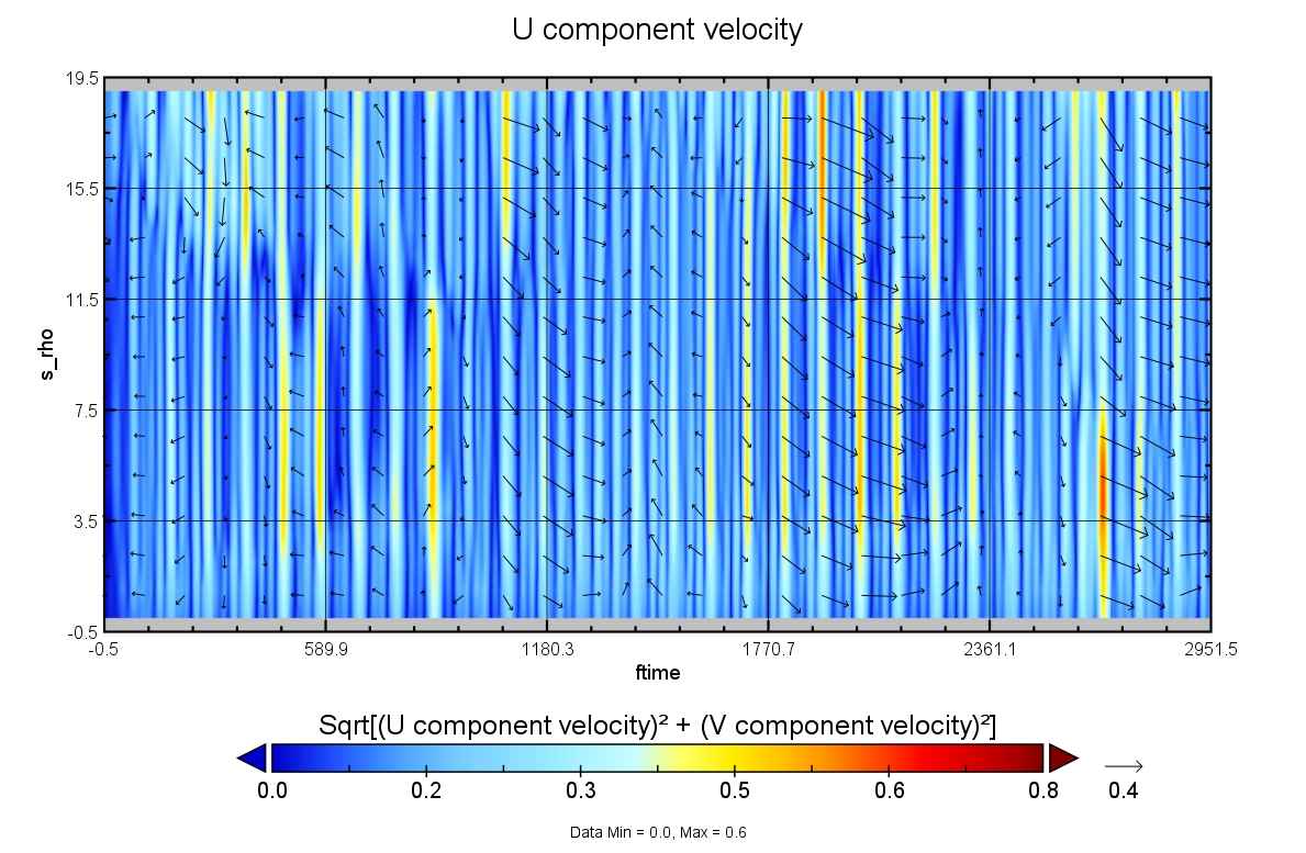

However, I found that the results of the run seem to be very different from the measured data.

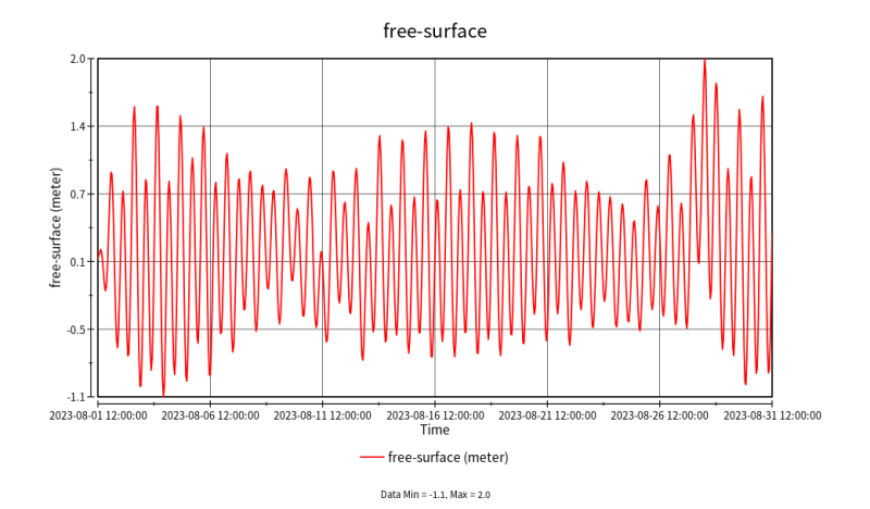

Firstly, the tide level data, i.e. the zeta trend is very wrong.

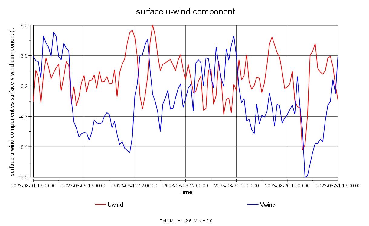

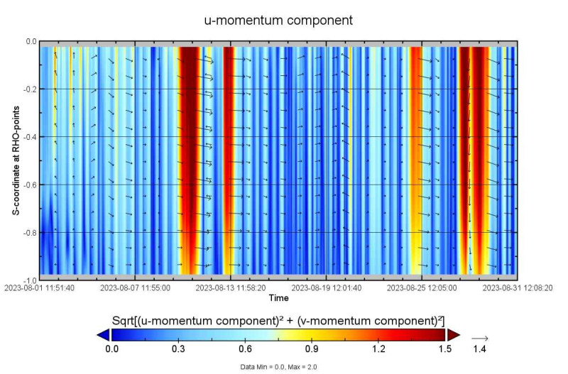

And secondly, the current is particularly strong with the wind.

I put the same bry, clm, ini files as above into croco mode and ran them, and it turns out that the croco mode arithmetic is not that far off from reality.

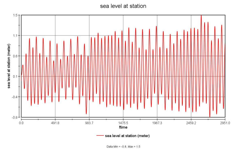

Re: wind -current- Zeta, Inaccurate simulation results

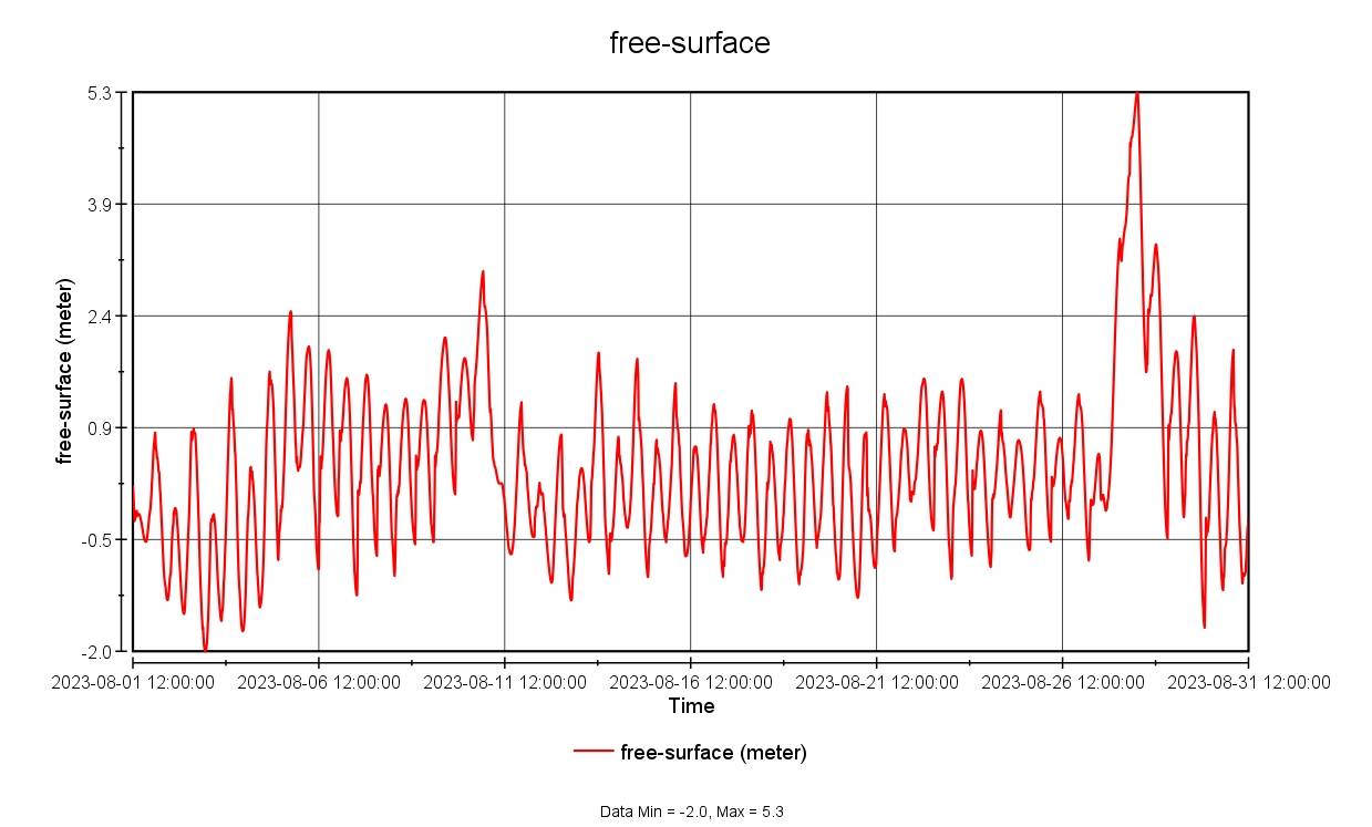

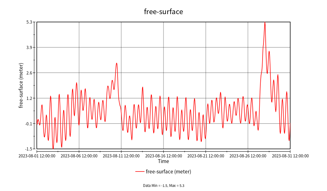

These are the results from the croco mode run

Thanks for your reply.
At the beginning, I only added two cpps related to tides, namely uv_tides and ssh_tides, and bulk_fluxes to the original file of upwelling.h, and turned off some ANA_GRID and other things related to the parsing function ANA, but the results I got from running were not very different from the ones I'm now getting from these cpp scenarios. The run results I get are not very different.
Even when I added BODYFORCE , FSOBC_REDUCED and other stuff, it didn't make a significant difference to my results, so this is confusing me.
I tried to look for inspiration from other people's solutions, and that's how it came to be as shown in this file.
I've also tried asking other people and using other people's solutions, but I can't get the results I'm looking for either.
I'm wondering if it's because I didn't add waves to the project, but I didn't try to use the swan coupling because the source code seems to have a lot of bugs, and I'm also trying to use the inlet_test demo example, but it doesn't compile successfully, much less run!
At the same time, I also discovered a strange phenomenon. Further offshore, the tide level at this point seems to be somewhat normal. But closer to the shore, the sea surface height is a bit strange, and it seems that seawater accumulation has occurred.wilkin wrote: Mon Mar 04, 2024 12:25 pm You have CPP flags in there I don't recognize from myroms.org .... OBC_NUDGING, CORE_FORCING, ALBEDO_CLOUD ... etc.
If this is COAWST or CROCO I suggest you post your query on those forums.
The sea surface height shown in this picture is far away from the coast, while the sea surface height shown in the above pictures is relatively close to the coast.zhy202303 wrote: Tue Mar 05, 2024 1:49 amAt the same time, I also discovered a strange phenomenon. Further offshore, the tide level at this point seems to be somewhat normal. But closer to the shore, the sea surface height is a bit strange, and it seems that seawater accumulation has occurred.wilkin wrote: Mon Mar 04, 2024 12:25 pm You have CPP flags in there I don't recognize from myroms.org .... OBC_NUDGING, CORE_FORCING, ALBEDO_CLOUD ... etc.
