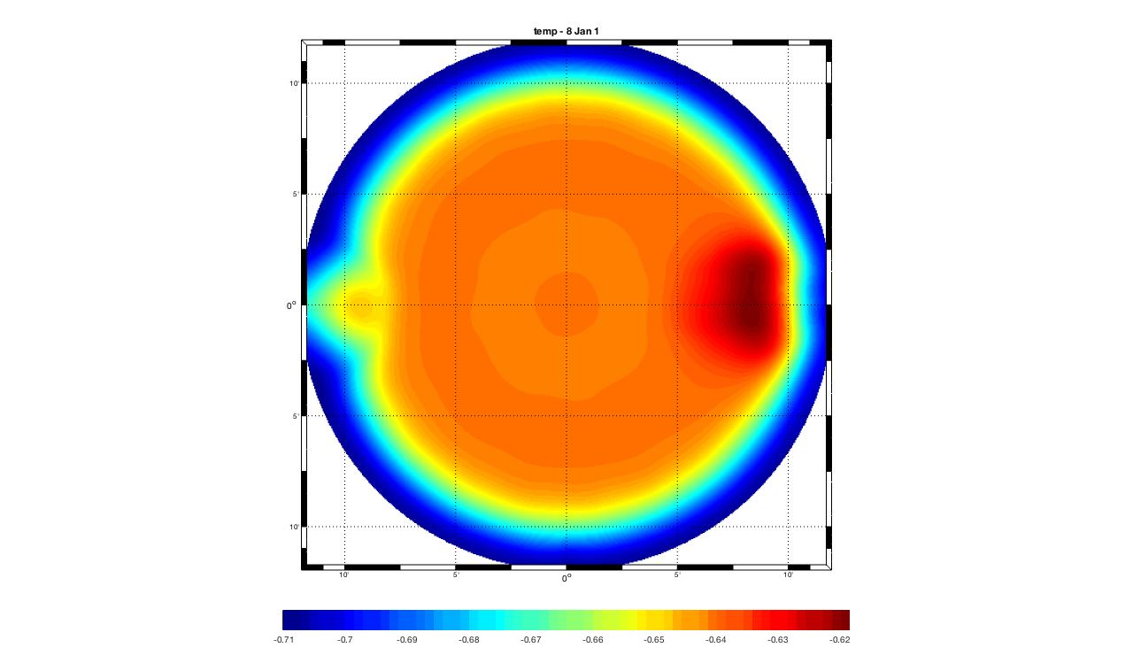

I added two rivers (using create_roms_rivers.m in COAWST m files) to my idealized ice-covered lake with a homogenous salinity of 14 psu. The surface temperature was set to freezing point temperature, with an initial linear stratification within the water column to a temperature of maximum density at the bottom. There were 45 km (500*500) of length and 150 m of depth (30 vertical layers) in my lake.
The river direction in both rivers is 0 (x-direction), and river transport is 1. The river temperature was set to freezing point temperature, and the salinity was equal to 0 psu.
I ran the model (LuvSrc was true). I found that one of the rivers had an inflow and the other had an outflow. It is difficult for me to understand how these rivers flow in different directions.

Rivers can be tricky! Each uv-source is either a u-source or a v-source. Each u-source is either going to the east or to the west. You want one of each, so one is positive, one is negative. When following a realistic coastline, I have some Python code to figure this all out for each source (used to be Perl).
