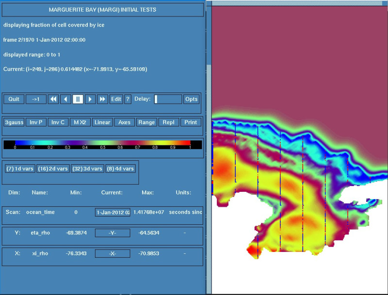

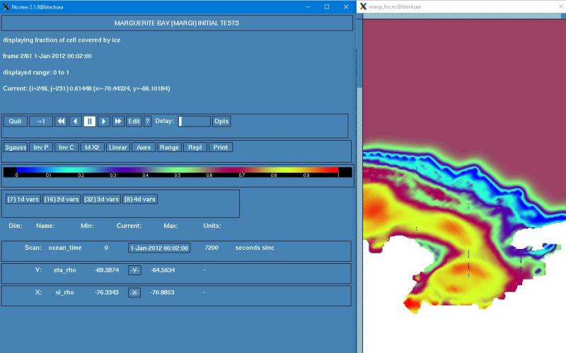

Hi All,
I am running a fork of Kate's ROMS-Ice from Trond https://github.com/trondkr/NS8KM-ROMS.
I am getting this weird leak like artifacts around especially xi-direction CPU tiles for ice related parameters. The model is running without! any other significant problems (as far as I can tell).
I am getting them especially on aice (ice fraction) and hice (ice thickness) variables. For example, I am not seeing these artifacts at Temperature or salinity variables.
I am attaching two figures one with 4x4 tiling and one with 8x16 tiling.
My guess is it might have something to do with the Halo ~ Ghost Points, but I can quite put my finger on it.
Can anybody suggest a fix for the problem?
Thank you.
Best,
Bilge.

Posts: 1383
Re: Leak/Artifact at CPU Tiles
#4 Unread post by arango »
That's a classic parallel collision bug of state variables computing horizontal operators. They are tough to find and usually take much TotalView debugging time. It implies that the ice state variable illegally accesses global data belonging to another parallel tile somewhere in the DO-loops. We use local arrays to evaluate the horizontal operators in such cases. I assume that you are running in distributed memory (OpenMPI). Such errors are more fatal in shared memory (OpenMP).
