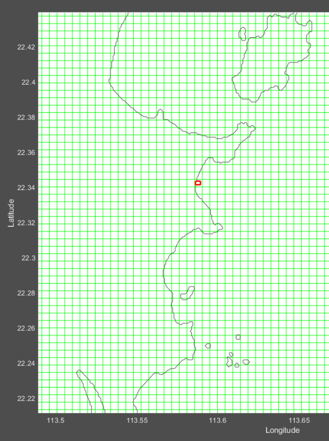

For bdry values, I set all cells to 0. Specifically, the source cell is show in the figure, the west side of the cell is land, and other three sides are ocean.

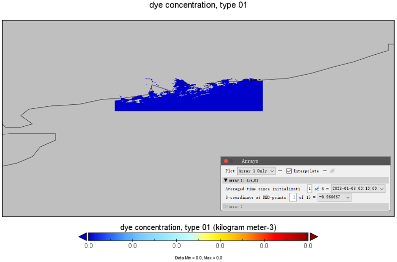

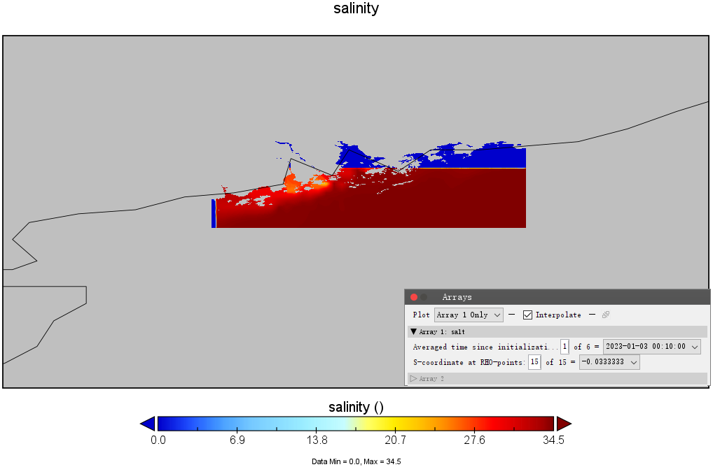

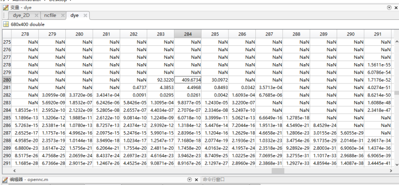

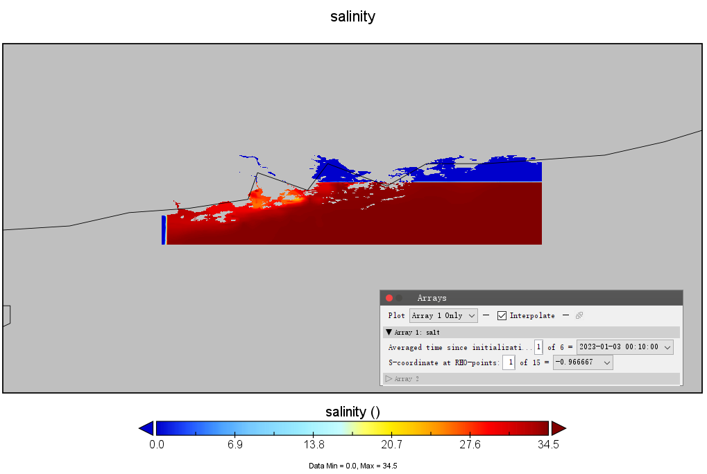

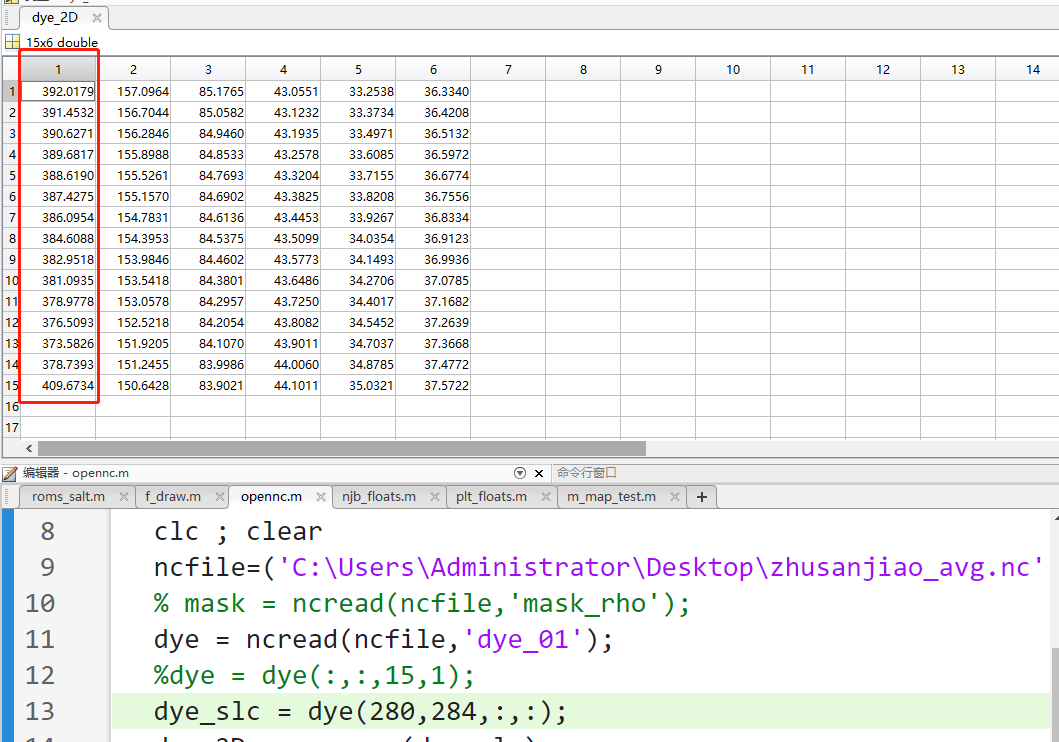

The program ran successfully. But when I pre-checked the results in Panoply, I found that the dye concentrantion is 0 everywhere(any time and any levels). There is also a problem with the salt calculation result: the concentration should not be 0..Does anyone know where the problem is and how to fix it?
dye concentration
dye concentration
salt concentration
salt concentration

According studying the official website, I know that the applilcation of Input River(Point Sources) can satisfy my simulation requirements as well(probably?), and I will try to Input River (Point Sources) for my simulation experiments these days. To the honest, don't know the difference between Adding passive tracer and Inputing River (Point Sources).. :cry: :cry:
Altogether, my questions are:
1. What causes the dye concentrations in my calculation result to be 0 and the salt concentration results to be abnormal?
2. In order to be able to simulate the diffusion of liquid substance(dye, sewage or liquid metal salts etc..) in the ocean, should I add passive tracers or input River(Point Sources) or combine the two?
Thank you very much for watching, and any kindly suggestions and guidance from you will bring me great help!! :D :D
Thanks again!

Dear Dr.Wilkin,
Thanks for your prompt reply! According to your guidance, I set OBCFAC to 1, set the initial value to 10000.
>> a = ncread('HYCOM_GLBy0.08_2023_003_ic_ZHUSANJIAO.nc','dye_01')
>> a(280,284,15,1) (wet cell)
ans =   10000

After some tests, I found that when the initial value is lower than 10000, I can find dye concentrations from avg.nc, when the initial value is higher than 1.e+6, dye concentrations will become 0 everywhere. So I guess, too high initial value caused all the concentration values to be 0?However, a low dye initial concentration(10000) is not very meaningful for my simulations. Because even the surrounding cells, as the model runs, their dye concentration values ​​quickly get very close to 0.
surface dye concentration
Maybe I could set initial values for multiple cells, or switching on River (Point Sources) Input is a better solution? Doctor, could you please give me some suggestions?
According to avg.nc results of running 10min, I found that the concentration of water colomn where the cell with initial value is set is aoubt 400.The six columns in the table represent the results of six different operation times。Is there a problem with too average concentration?
dye concentration
dye concentration
Even though I changed the OBAFAC and boundary conditions, the salt concentration still showed an abnormal value of 0.
salt concentration
salt concentration
Thanks for your kindly attention, and look forward your reply!

Is that the salt initial condition you want? I doubt it. I think you need to sort out the basic solution before you worry about dyes.
And why all the little lakes in the land?
Zeng
Posts: 28
Joined: Mon Sep 19, 2022 1:06 pm
Location: Sun Yat-Sen University
Re: Problem of adding passive tracer(dye concentrantion is 0 everywhere after calculation)
#5 Unread post by Zeng »
wilkin wrote: Fri Mar 17, 2023 11:31 pm Is that the salt initial condition you want? I doubt it. I think you need to sort out the basic solution before you worry about dyes.
Thank you, doctor. I found the reason why some salt concentrations in avg.nc file are abnormally 0. Because there are some unexpected 0 values of salt concentration in my ini.nc file.
I made the ini.nc file by pyroms, and everything is normal before running the remap_weights.py and make_ic/bdry/clm.py scripts, because before the remapping, there were no unexpected 0 values, and after the remapping, 0 values appeared. Since there are not many parameters in the remap_weights.py and make_ic/bdry/clm.py scripts that I need to set, I am not quite sure what the problem is..
Sorry, doctor, there were some inland lakes in my grid, and they were masked now.
