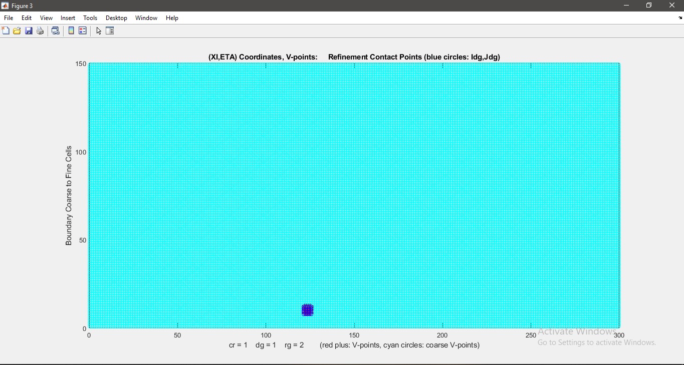

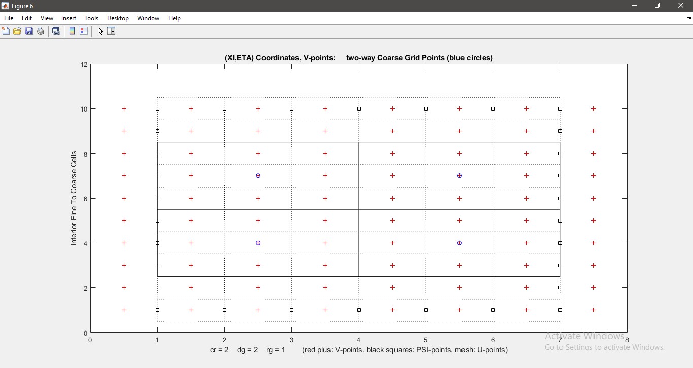

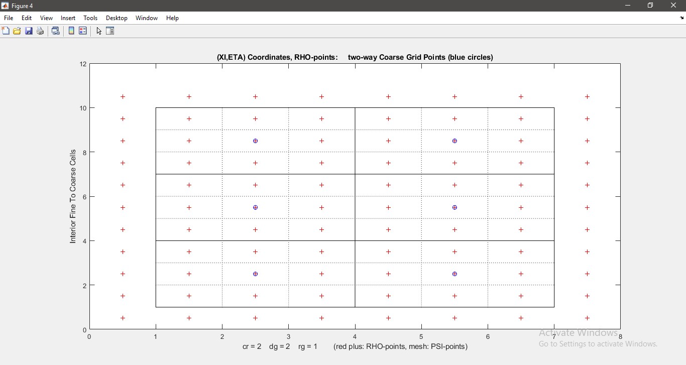

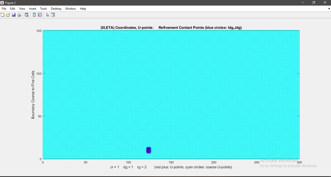

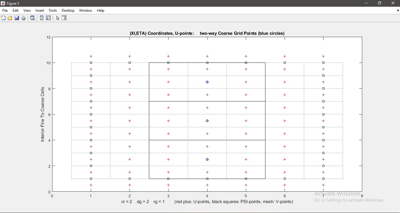

I also got the following figures in my MATLAB.>> Gnames = {'phillipines_grd_1.nc', 'phillipines_grd_1_c.nc'};
>> Cname = 'phillipines_contact.nc';
>> [S,G] = contact(Gnames, Cname);
Summary of Contact Regions Processed:
Grid 01: phillipines_grd_1.nc
Grid 02: phillipines_grd_1_c.nc
Contact Donor Receiver
Region Grid Grid
01 01 02
02 02 01
Subscripted assignment between dissimilar structures.
Error in contact (line 329)
S.refined(cr) = R;
Is that an issue with my coarser grid file which I created using gridbuilder tool ? Or is it an issue with finer grid ? Is there a way to remove it ?
Any help is appreciated by me.
Kind regards
-Neel
