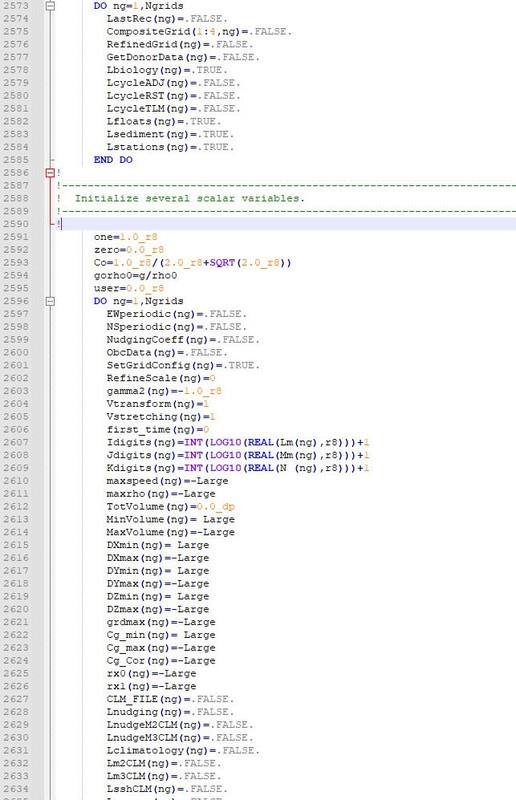

maybe you could help a bit and track that message, what is on
/mnt/c/Users/lyras/OneDrive/install_roms/folder_tes/Build_romsG/mod_scalars.f90:2595

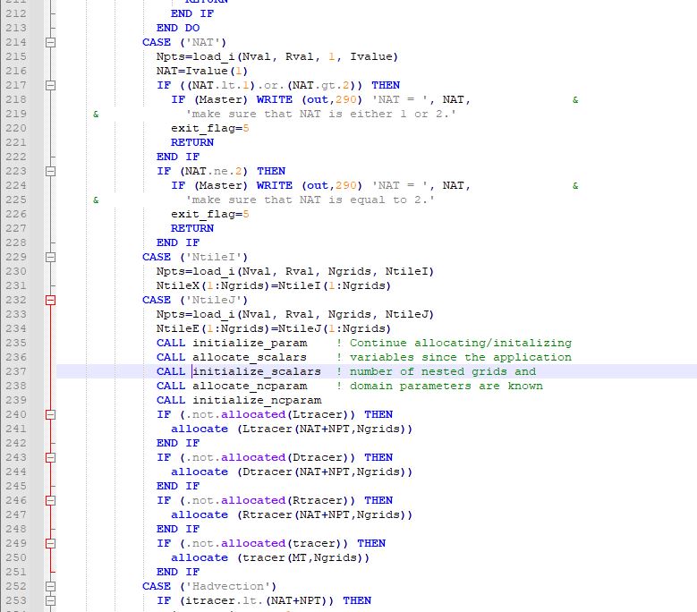

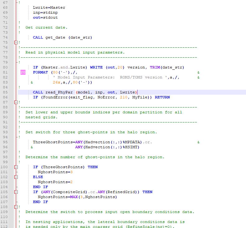

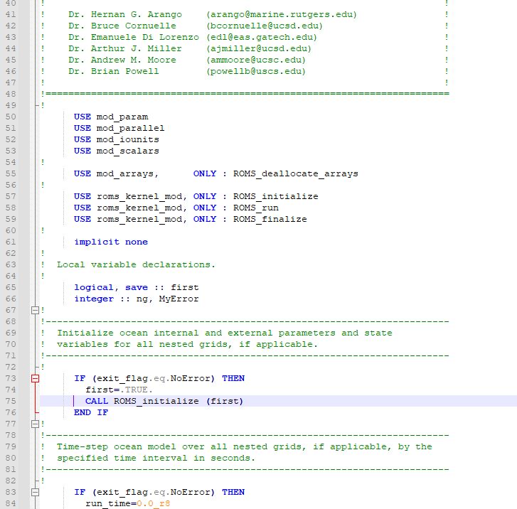

Hello, jcwarner, this is the hint of the error:
read_phypar.f90:237
inp_par.f90:85
roms_kernel.f90:86
master.f90:50-75
