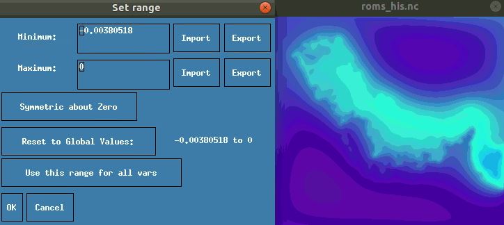

I checked record 3 of the history file and as you said the problem was in the bathymetry then I used romstools for creating grid and tide and run the model and the model run correctly
finally, I checked the zeta parameter in .his file but the Results of zeta were not in the desired range(should be somehow -1.5<zeta<+1.5) Thank you for your patience
