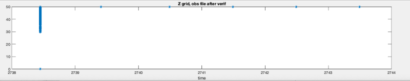

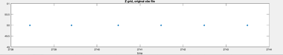

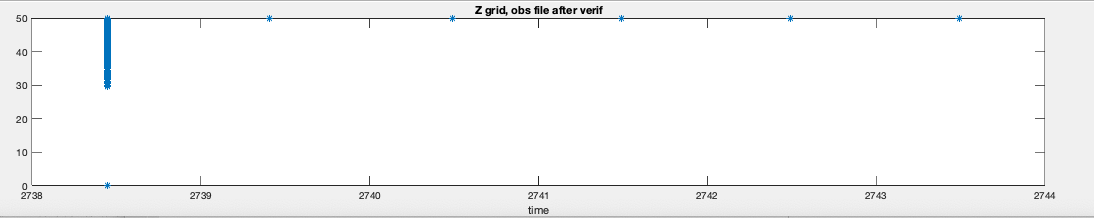

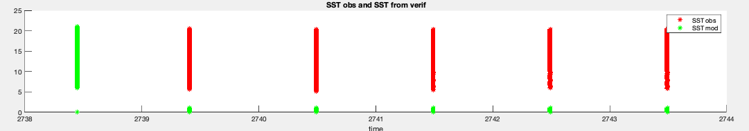

Re: observation data rejected!
I am seeing some unusual behaviour with Zgrid when running VERIFICATION.
In my input obs.nc file I have Zgrid=50 and depth=-2 for SST obs (my model has 50 layers).
When I run the VERIFICATION, the obs file is written to and altered. For the first day (of 6 daily times for which I have SST data) the Zgrid is altered from 50 to zero in some places and to range from 30-50 in others. At all following days Zgrid is left at 50.
The SST values that are output to the mod file are incorrect when the newly written Zgrid=50 and Zgrid=0, and only make ‘some’ sense when Zgrid is between 30-50 i.e. on day 1.
I tried writing Zgrid as 49.8 rather than 50 but I still get the same error. I also tried leaving Zgrid at 50 and changed depth to 0 for SST, same error. I also tried swapping Zgrid and depth in the obs file, as I have done in 4D-Var applications in the past, but still get the same error.
For SSH I have Zgrid=50 and depth=0 and the data is output correctly. Likewise I have some subsurface obs that are output correctly.
