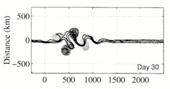

(3) change the initial wind stress (tau = 0.1 Pa from East) to an initially stable and steady jet flowing into the domain from the centre of boundary
So that I can hopefully produce a scenario similar to the figure attached after running.

What would be the best way for me to get a flat bottom topography of 4000 m bottom depth? I know I can edit the 'depth', but the bathymetry flatness I am not entirely sure.
And additionally, for (3), I can't yet find where I can edit to change the initial wind stress (tau = 0.1 Pa from East) to an initially stable and steady jet flowing into the domain from the centre of boundary; or even to start with something easier, to just change the wind initial condition to a different value or different direction.
Many thanks in advance for any helpful words or tips to get going.
