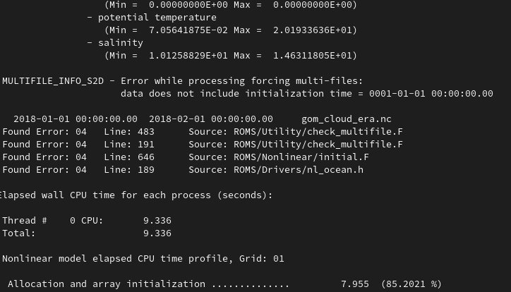

Dear users,
I have made my grid and initial condition files. The model runs after applying both files. However, after applying the forcing files, I have faced the following error. To make forcing files, I have used decmwf2roms Matlab manuscript and my forcing files(13 files) are for one month from 1 January 2018 to the end of this month. I don't change any time in my ocean.in. Should I change the time in ocean.in based on my forcing file?
please help me with your interesting comments.
Re: Running error
All of your times have to be consistent, however you choose to do that. Pick a time origin and stick with it, in both your input files and ocean.in.
