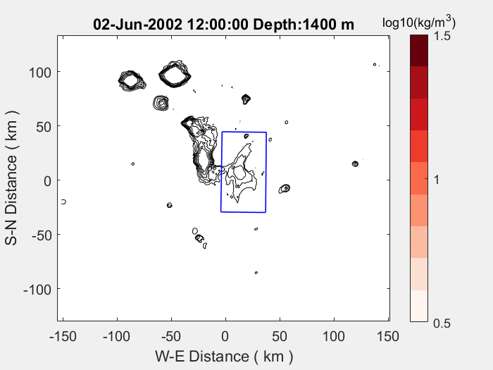

I have recently finished a two-way nested simulation to study the dispersal of tracers from an underwater volcano. The attached is an animation showing the preliminary results. Basically, my grid configuration is of the refinement type with a small fine grid (blue box) embedded inside a big coarse grid with a refinement factor of 5. The simulation includes realistic bathymetry and the currents are driven by realistic surface, tidal, and sub-tidal forcing that is applied at the open boundaries of the large domain. Overall, I am very impressed by how well the two-way nesting works in ROMS. As the animation shows, the presence of the nesting interface does not appear to affect the dispersal of the tracer and flow through it, which is what I was hoping to see.
Here is my question. The bathymetry I used is the same for both grids with the resolution matching that of the coarse grid. Naturally, I would like to use a more finely resolved bathymetry across the fine grid. This leads to a question of whether the differences in bathymetry across the nesting interface could be problematic. In other words, is it necessary to apply some kind of filtering method to smooth the transition between fine and coarse bathymetries across the nesting interface or this kind of smoothing is done implicitly in ROMS through vertical interpolation at contact points?

- dye_hor_1400m_coarse_heat_dye.gif (1.36 MiB) Viewed 8230 times

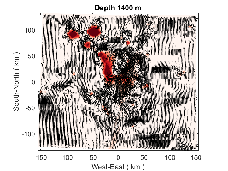

I have finished a new run wherein the bathymetry is refined within the child grid. I did not make any adjustment to the refined bathymetry near the nesting interface since I mainly wanted to see how the nesting works in the presence of the differences in bathymetry across the interface.
The results are not good, though. As you can see from the attached diagrams of the 30-day averaged velocities sampled at a given depth (1400 m), the velocities within and near the refined child domain do not look right. This is confirmed by comparing the simulated currents with the measurements taken above the seamount, for which the match gets much worse when the high-resoluation bathymetry is used for the child domain.
This seems to suggest that it is important to eliminate differences in bathymetry across the nesting interface. I will try John’s approach and see if that solves the problem. In the meantime, I would like to know if the conventional wisdom is to make sure the coarse and fine grids share the bathymetry and thus sigma levels at the contact points.
