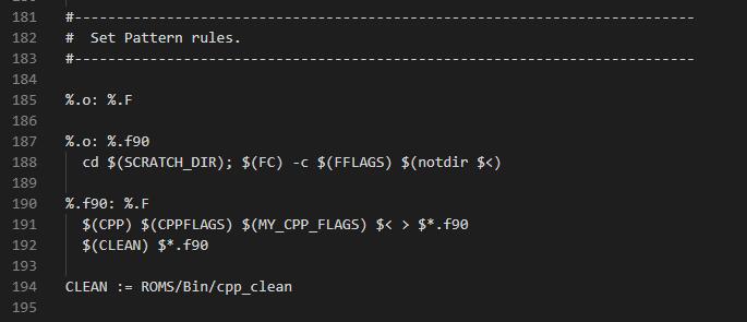

I want to add a new mod.F90 to the ROMS. Which file do I need to add the path of this mod.F90 to?
If I change the suffix .F90 to .F, the program can be compiled successfully
Re: Add the path of a new Fortran90 file
The makefile has rules for going from .F files to .f90 files to compile them into .o files. You would have to add rules for .F90 files if you refuse to rename your file.

What rules do I need to add to makefile? Is it added in lines 181-195?
kate wrote: Wed Jul 01, 2020 5:01 am The makefile has rules for going from .F files to .f90 files to compile them into .o files. You would have to add rules for .F90 files if you refuse to rename your file.

I don't think so. It instead uses:
define compile-rules
  $(foreach f, $(local_src),       \
    $(call one-compile-rule,$(call source-to-object,$f), \
    $(call f90-source,$f),$f))
endef
and friends. The compile-rules function is called in the Module.mk files.

#6 Unread post by kate »
