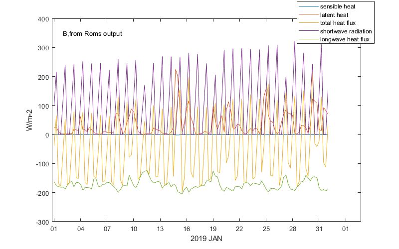

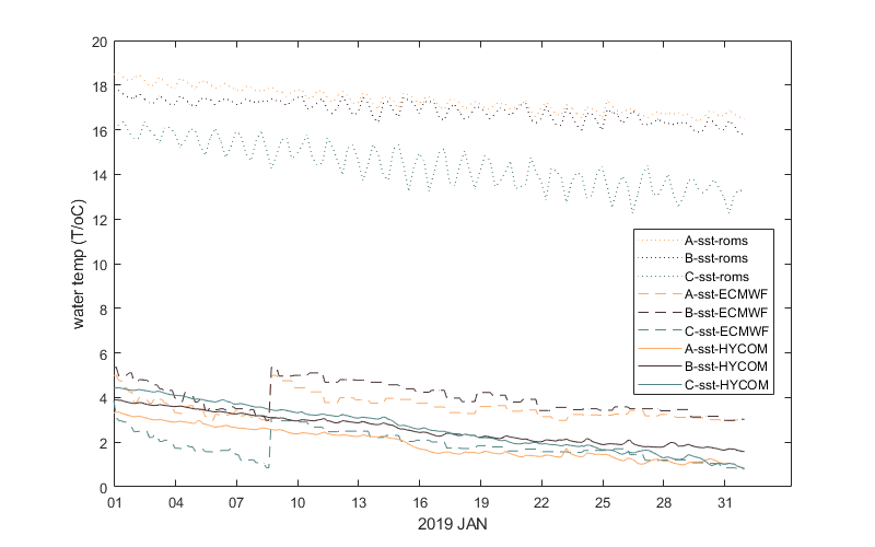

Thank you for your help in advance. There are some problems with my result of water temperature.
My roms result of water temperature is much higher than data from ECMWF or HYCOM from attached figure 1. And I think there is something wrong with heat flux so I compared each component in heat flux in attached figure 2. The problem is, apparently, the sensible heat flux is almost 0 all the time and latent heat flux is positive (latent heat should be negative).
The matlab code used to generate input netcdf is:

Thank you, Hernan.
I turned off SPLINES_VDIFF and SPLINES_VVISC but the result is almost unchanged. I think there are something wrong with latent heat and sensible heat calculation. The CCSM_FLUXES calculates heat flux over open water with iteration which I can't understand :?

I have turned off ICE_ALB_EC92 and tried BULK_FLUXES. But the latent heat flux calculation of BULK_FLUXES is unstable and the model blew up. And I have checked the units of all inputs, they are reasonable.
I think I'd better try directly input surface total heat flux instead of calculating it with flux formulation. Do you know how to set CPP options to make ROMS directly need shflux, swflux, swrad, sustr, and svstr?

Problem solved :D . I changed unit of specific humidity from percentage to kg/kg, and unit of air pressure from millibar to Pascals, then the result of water temperature is reasonable. Seems that different versions of ROMS wants different units for the same variable.
Thank you very much, Kate, I really appreciate your help!
