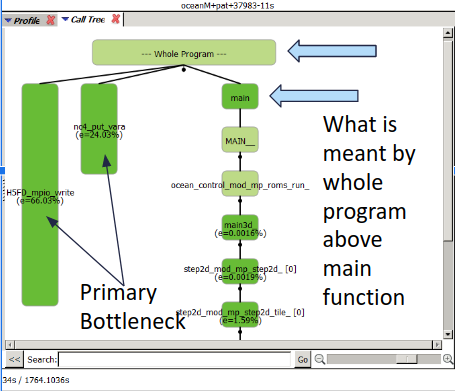

I am using Cray PAT prfiling tool to find the bottlenecks in ROMS application.
I have used NetCDF4-HDF5 parallel with 1440 PEs for this experiment and writing 5 Quick files.

Doubts:
1. What is meant by Whole Program on top of main ?
2. Why H5FD_mpio_write and nc4_put_vara is called even before main function and they are consuming almost 66% and 24% of the total execution time(It is almost 90% of the execution time)?
