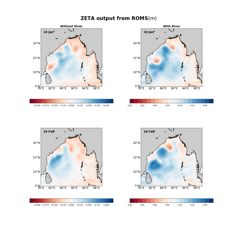

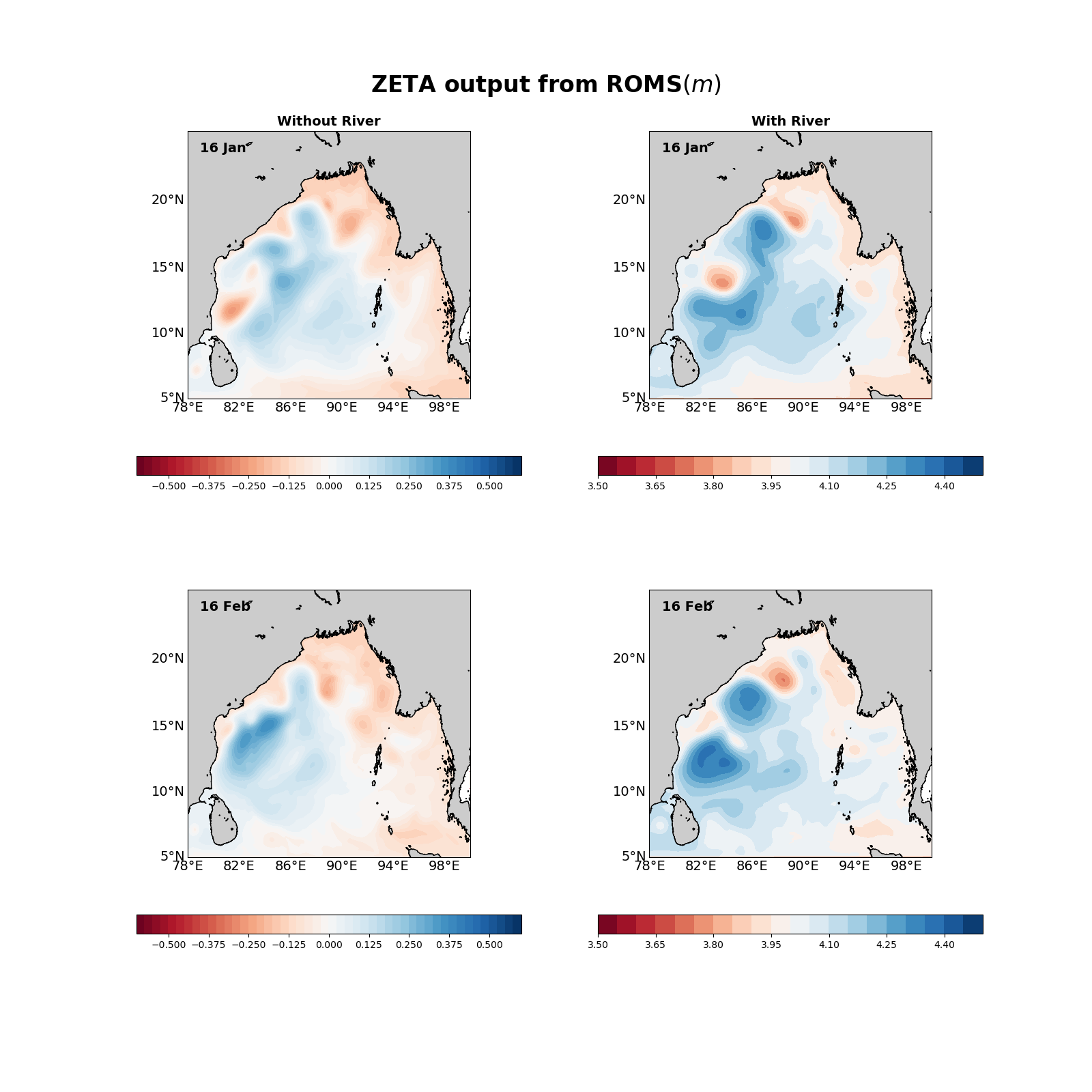

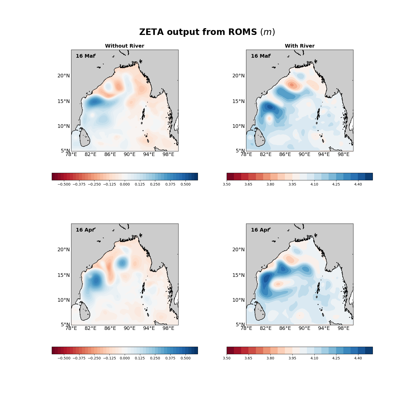

3 After analyzing the output I compared the zeta which seems to be very high in the case when the river is added
Both simulations are identical in every manner except I switched on the LuvSrc == T and LtracerSrc == T T ( to add the river discharge in the second case)
I am attaching the log file for both the cases and plot for zeta output from ROMS output.

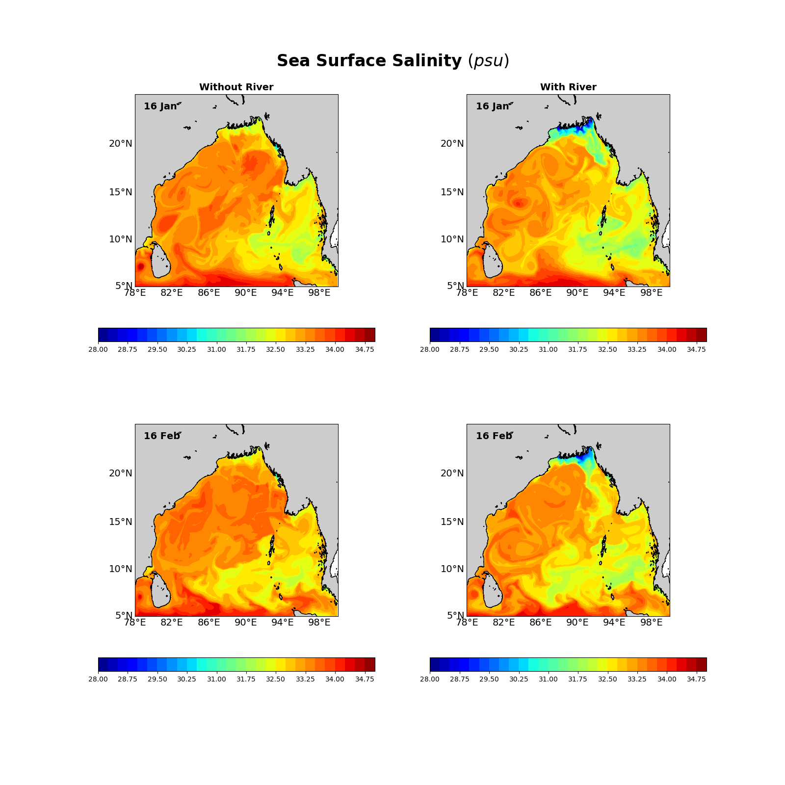

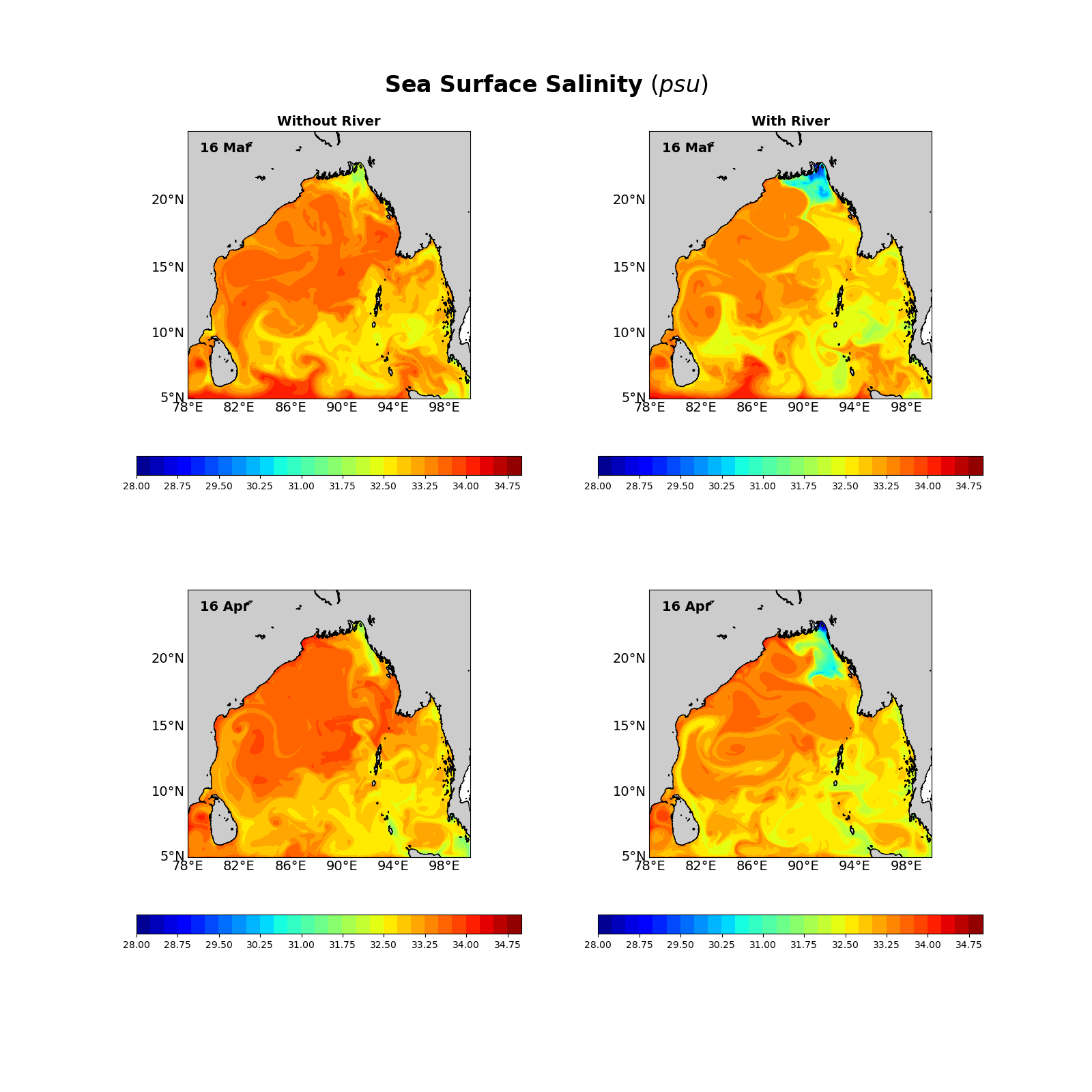

What about the surface salinity and velocity? Are you getting a run-away estuary where the surface is too fresh and fails to vertically mix down? I would expect there to be enough fresh water input there to change the results, but are they now more sensible or not? I can't tell from zeta.

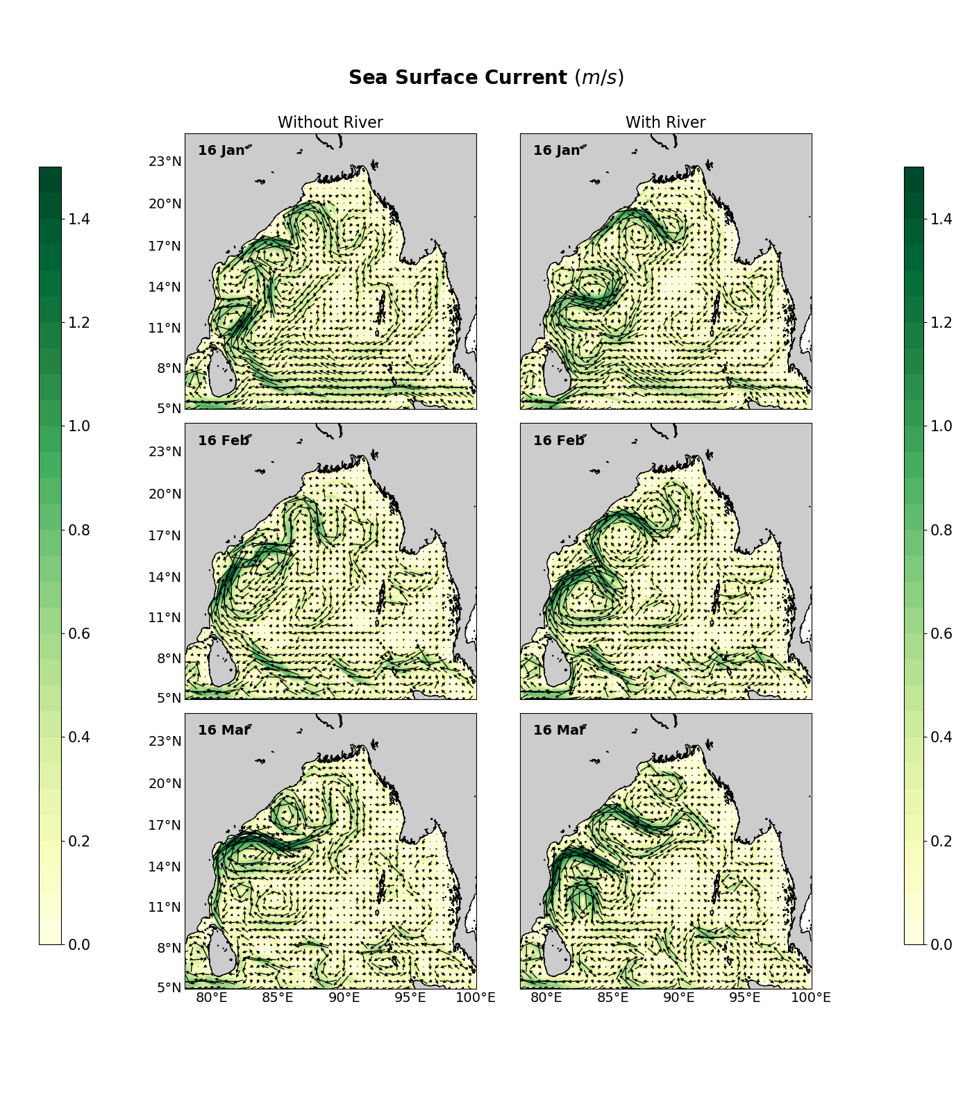

Hi kate, I am attaching the current profile and the surface salinity profile. Hope this will help you in understanding the problem in a better way.

Surface current plot
