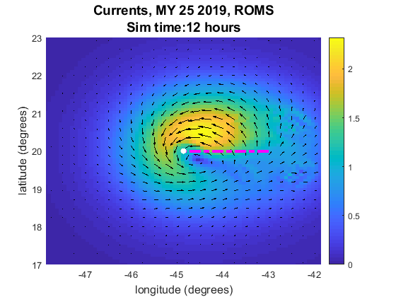

Surface currents at simulation time 12 hours (zoomed in to see the subtle instabilities):

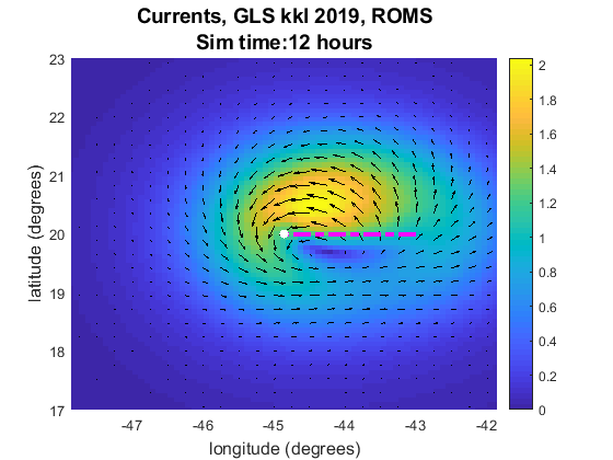

Surface currents at simulation time 12 hours (GLS kkl for comparison):

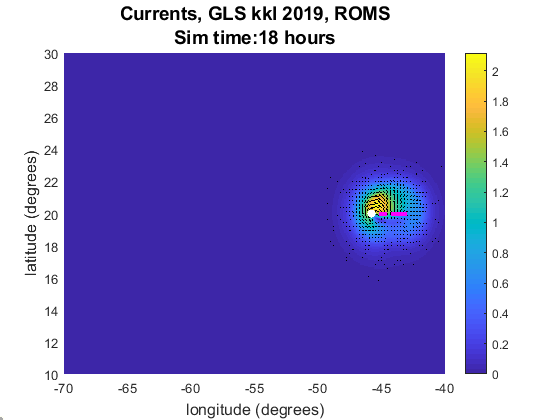

Surface currents at simulation time 18 hours (GLS kkl for comparison, entire domain):

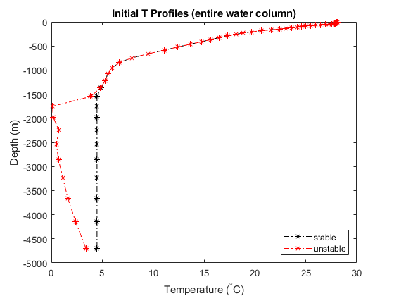

Sorry for the trouble, but the problem was the initial temperature profile. I used a monthly climatology T profile and then added the bottom part from an annual climatology T profile. The result was an unstable in-situ temperature profile instead of an idealized potential temperature profile. GLS_MIXING did not have any trouble with this, but it turns out that MY25_MIXING is very sensitive to the initial temperature profile.
Here is a comparison of the initial T profile that led to MY25_MIXING being unstable vs my new corrected initial T profile.
