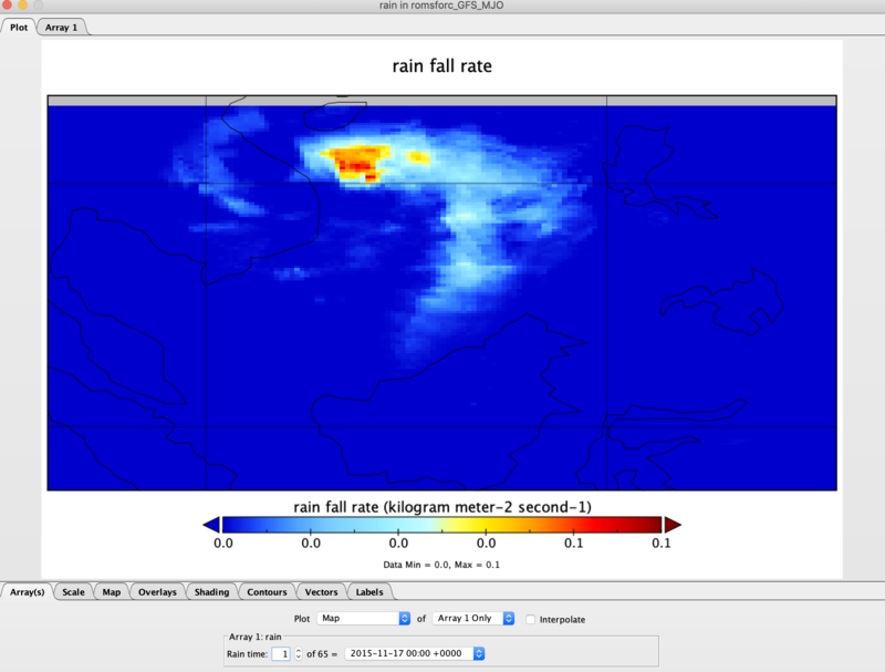

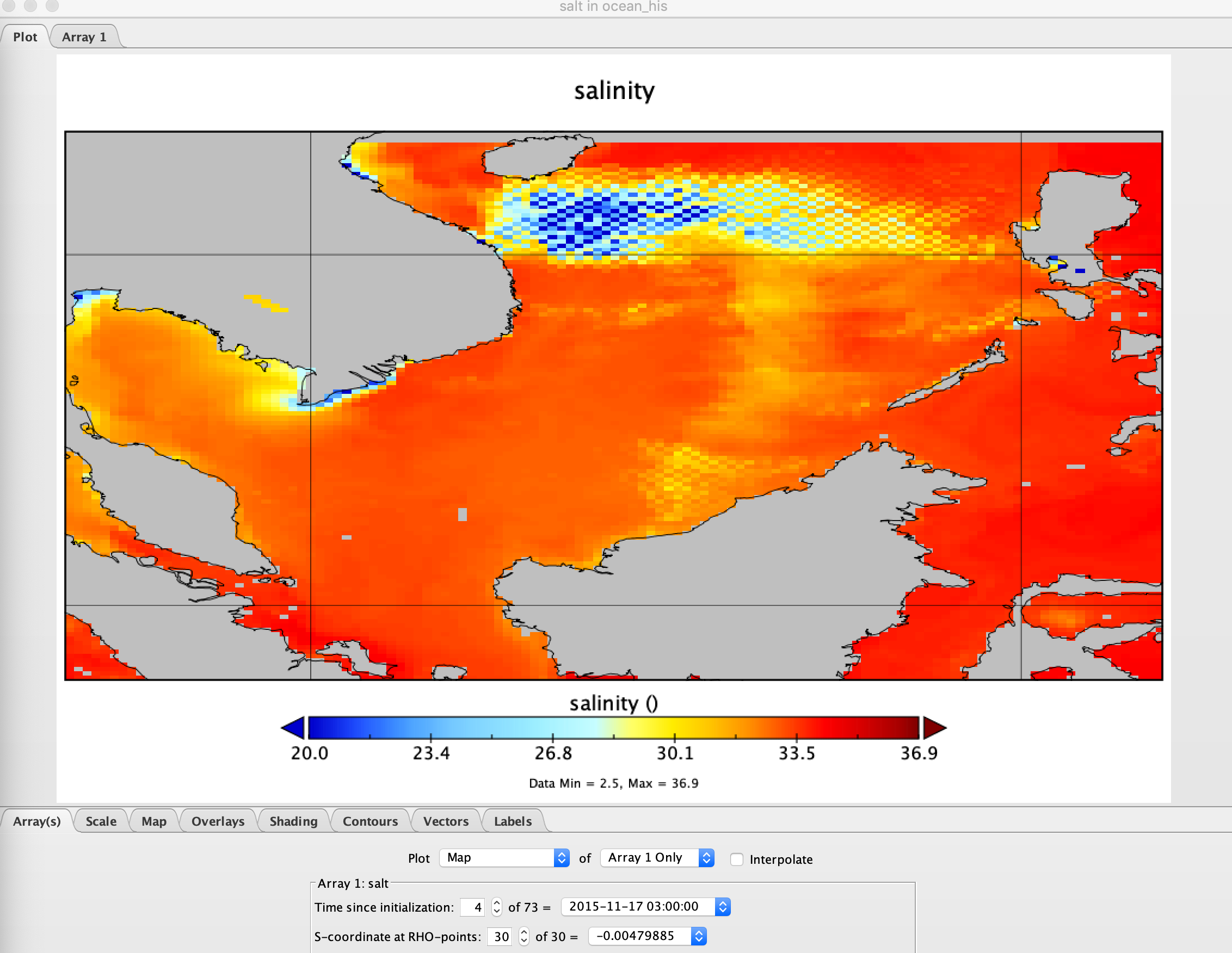

I'm facing a strange unrealistic discontinuity of surface salinity in my COAWST (only ROMS activated) attached below.
At the northern part, I found the freshwater flux was likely input at every other grid.
Actually, after the rain stops, the salinity was reasonably diffused by horizontal diffusion and other mixing processes.

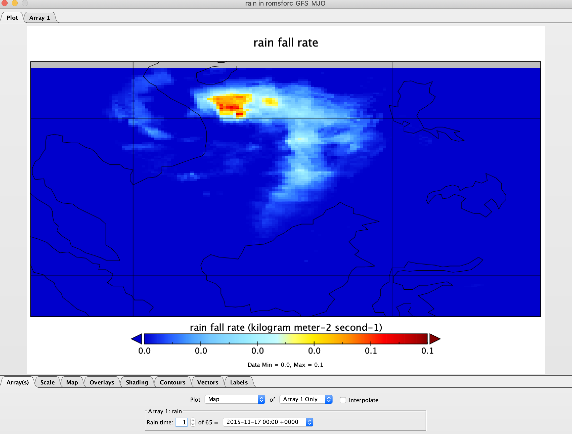

At first, I thought that was caused by my low-reso rain data (from NCEP reanalysis II, ~2.5 deg) comparing with my ROMS resolution (21 km).
But after I replaced the rain with GSMAP data(0.1 deg, attached), it still happens.

Rain data
Rain data
surface salinity at the first hour

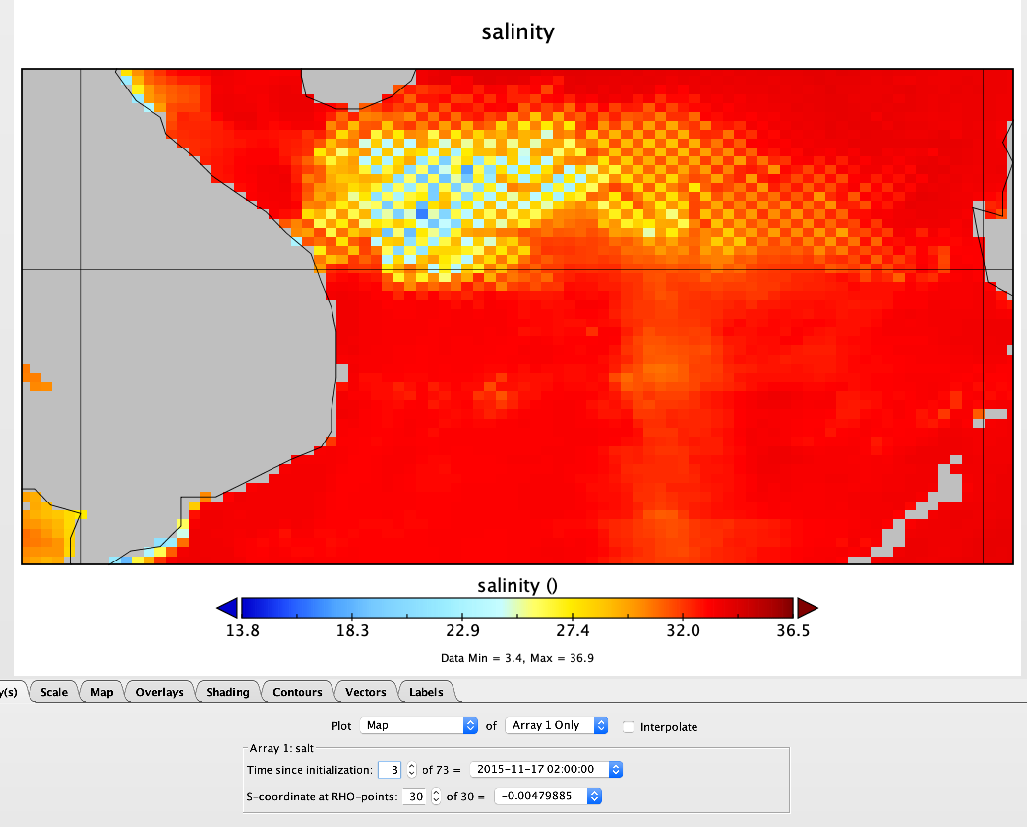

#3 Unread post by phalucy »
Thank you for your quick reply.
I tried the option LMD_SHAPIRO. It still happened (figure attached).
Could it be related to my horizontal vis/diff coef?
For now, they are:
DT=60
NDTFAST=30
TNU2 == 30.0d0 (I tried 25, 5, 1 also)
VISC2 == 300.0d0 (I tried 100, 25, 5)
My dx=dy=21km.
I also tried different cpp options (MIX_GEO_TS, MIX_ISO_TS).
But, none of them helped.
Would you mind check my ocean.in file (attached with name ocean_mjo.in) ?
Many thanks,
Ning
