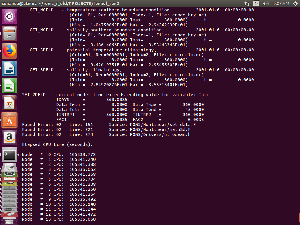

Can anyone please help me with the run. I'm attaching the screenshot of the error

I tried with cycle length 360 and 365.25 both are causing errors, however, my physical run is successful with the same files. I'm stuck with this error since a long time, so kindly help me.
