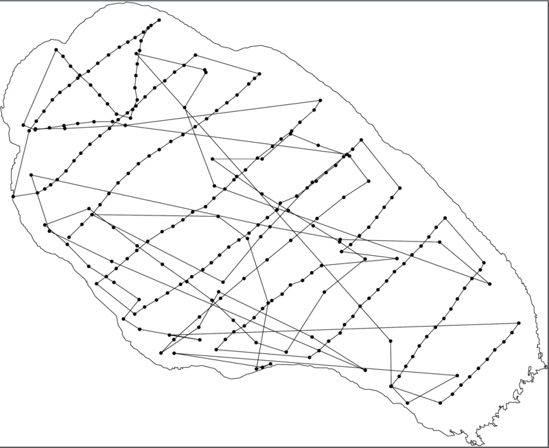

Recently I was asked to help set up ROMS grid for a lake which has its bathymetry data available only as
a set of point measurements from a boat: the depth was measured by echo sounder accompanied by GPS,
so the data comes as a file of the following structure, three numbers on each line
        latitude longitude depth
along the trajectory of the boat, which is traversed the lake, literally like this,
Raw data: coast line and location of measured data points for bathymetry.
where the dots indicate points where the depth was measured: the placement is sparse and irregular.
They are connected by thin line which is simply sequence of the points in the file - presumably along the
trajectory, but some zig-zags and crossing are hard to explain.

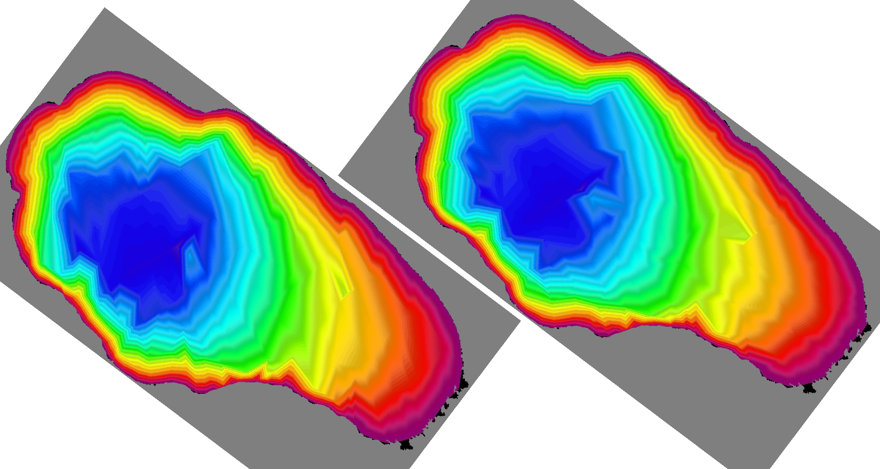

Obviously, the first try is to use Matlab griddata -- the results were not very promising, as expected. Another
thing I bumped into, is that an innocent-looking
 hraw=griddata(zlon,zlat,z, rlon,rlat);
[where zlon,zlat,z are geographical longitude,latitude, and depth of measured points expressed in
degrees,degrees, and meters; rlon,rlat longitude,latitude, of the target ROMS grid, also in degrees]
produce very erroneous result: it just connects wrong data points when doing triangulation.
Left: griddata applied directly to lon-lat coordinates (expressed in degrees) resulting in failure connect the nearest points, producing narrow triangles, and failing to achieve propery of Delone triangulation. Right - griddata in conformally projected coordinates.
The reason for this is because griddata interprets arrays passed to it through the arguments as Cartesian
coordinates, so it computes and compares distances simply as dt=sqrt[(x1-x2)^2+(y1-y2)^2]. Therefore,
because at 60 degrees North one degree in north-south direction means twice as much distance measured in
meters than one degree east-west, but griddata algorithm has no way to know about it.
I checked ROMS-related Matlab scripts available to me, and found that in most cases when griddata is used,
its arguments are geographical lon-lat coordinates. Obviously, Boris Delone would not be happy.
An intuitive way to correct the situation is to conformally transform the horizontal coordinates (both ROMS
grid and data points) into flat Cartesian coordinates: in the simplest case of very small domain just to
multiply longitude by cosine of the median latitude; a more diligent way is to use Lambert conformal
conical projection with its two standard latitudes optimally chosen for the particular modeling domain
(minimum distortion). For larger grids grids, and if the resolution is perfectly isotropic (pm=pn
everywhere) a good way is to transfer data points into coordinates of ROMS grid indices -- this is what I
ended up doing, however this option requires grid-index search algorithm which I do have (see later) and it
is independent of Matlab and griddata (seem that in Matlab world there only few options, and griddata is
the most often used for this purpose as well, even if the grids are regular. ...Any way, something needs
to be done.

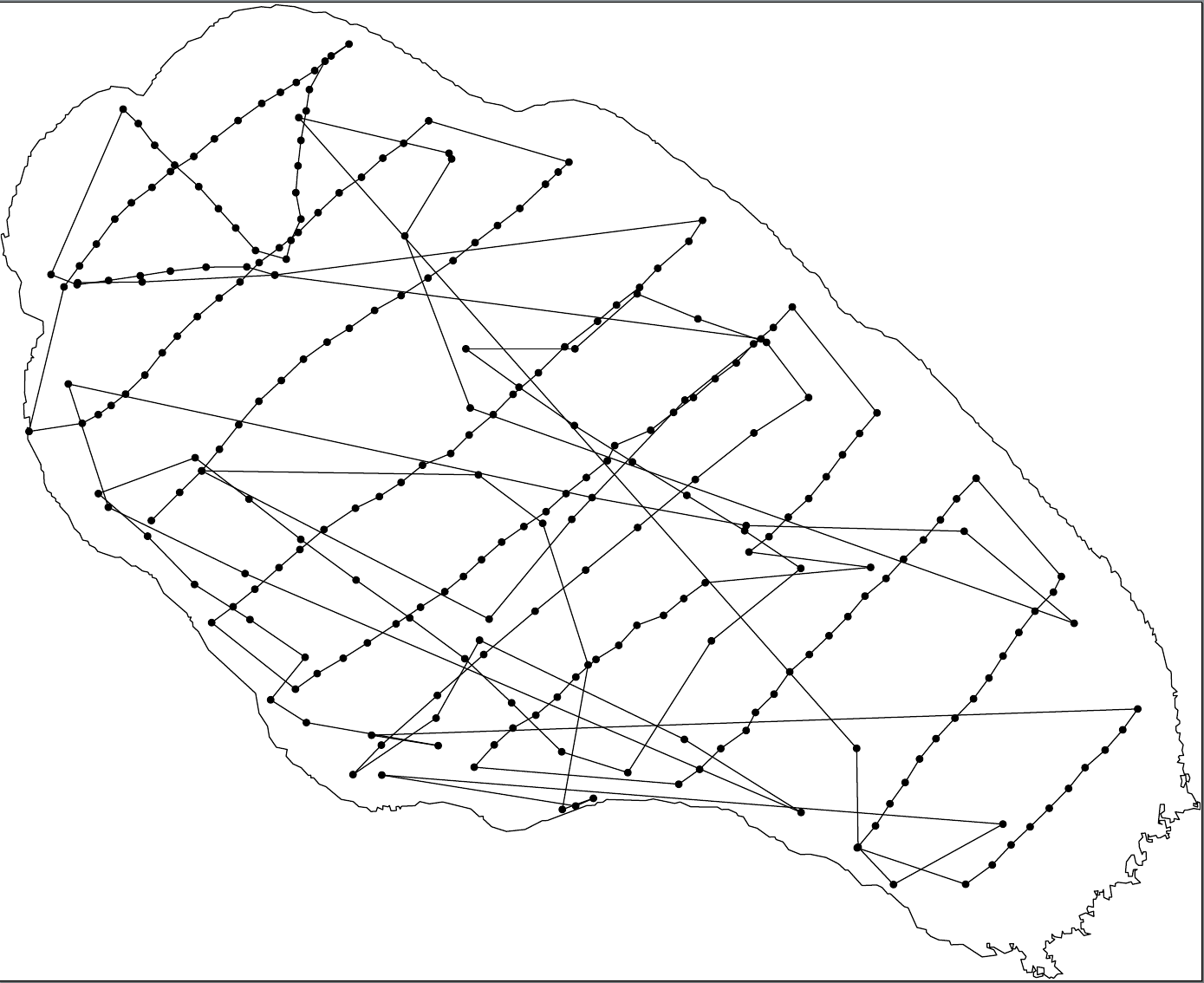

The next thing to be careful about is that before even start messing with griddata, the point-wise data
must be preprocessed to filter out points which are too close to each other, and potentially contain contradictory
data: either because of GPS errors or echo sounder errors, when the depth is measured again
in nearly the same location (perhaps a later time, or on different/return pass by the boat), the measured
value does not repeat itself exactly, but griddata tries to fit all the points available resulting in almost
vertical walls in the interpolated field it produces. So the augmented and preprocessed data looks like

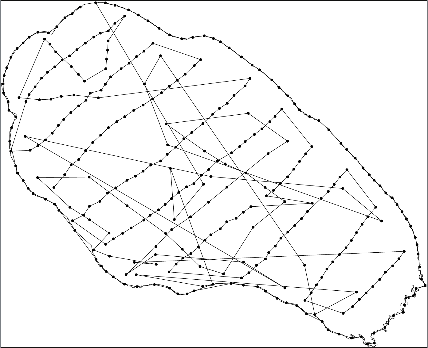

Preprocessed data: points which are too close to each other are averaged.
where all the data points which were closer than a user-specified minumum distance were averaged and merged
into a single point.
In practice it is a bit tricky because of the inherent data dependency: if three or more points come too
close to each other, the location of the averaged point may change the status of logical condition of whether
or not some of the source points should be averaged -- in may end up at some distance further away from its
neighbor. To resolve this, the procedure begins with a very small threshold -- only a fraction of user-specified
value, and gradually increasing it until reaching the user-specified value. This way, only two-point averaging
takes place at any stage (I cannot prove this mathematically, but experimentally this seems to be the case.
Also note that coastline points were averages as well. This is, strictly speaking, not necessary, but it
make it a little bit easier on griddata: depending on the option for selecting algorithm, it may take
griddata some time to compute these fields, or even fail to do so, complaining that "matrix is too big".

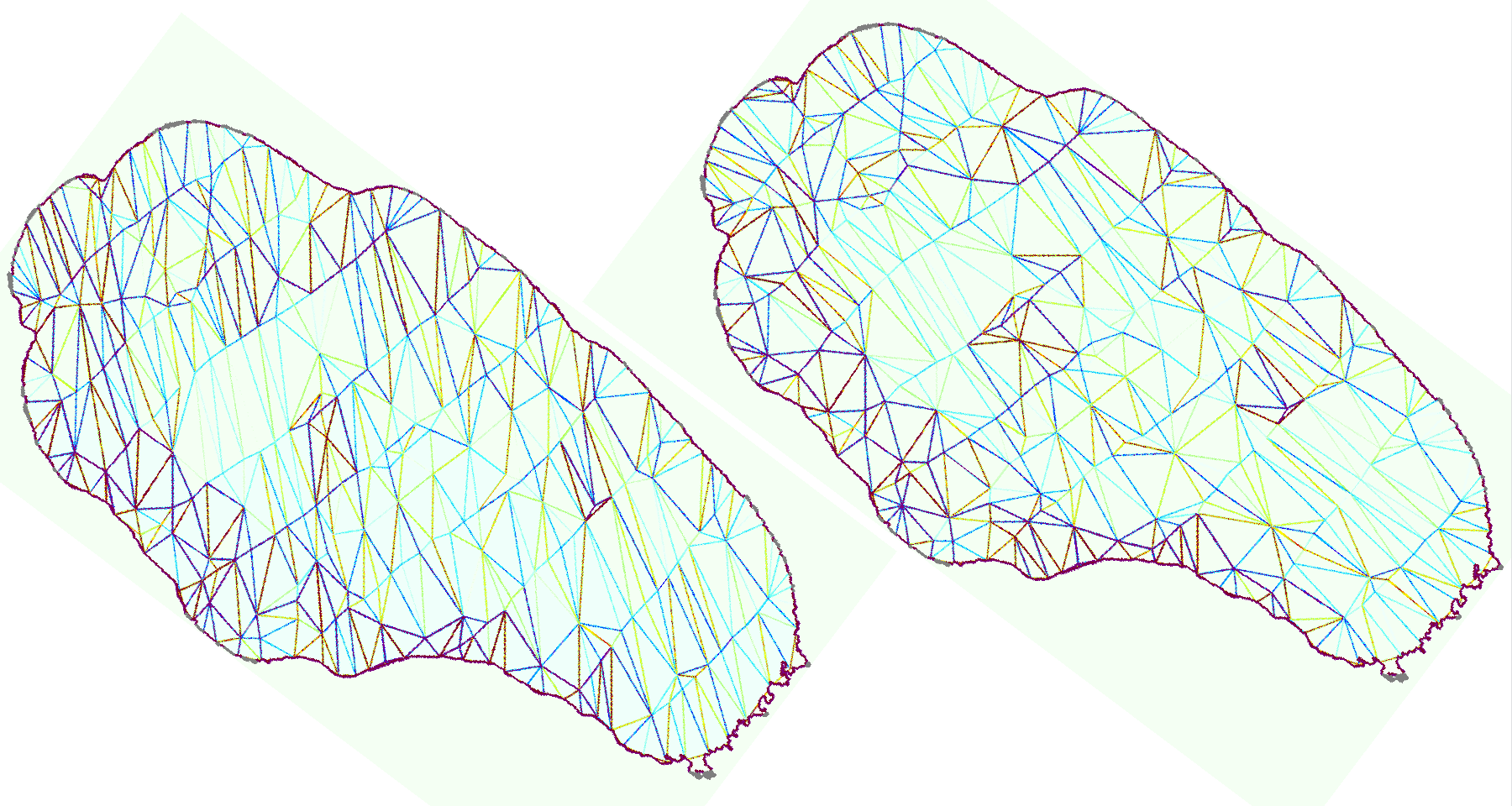

Trying all of them results in:
Linear option:
griddata(....,'linear'); Left: geographical coordinates; right in conformal. (these plots corresponds to triangulations shown above.

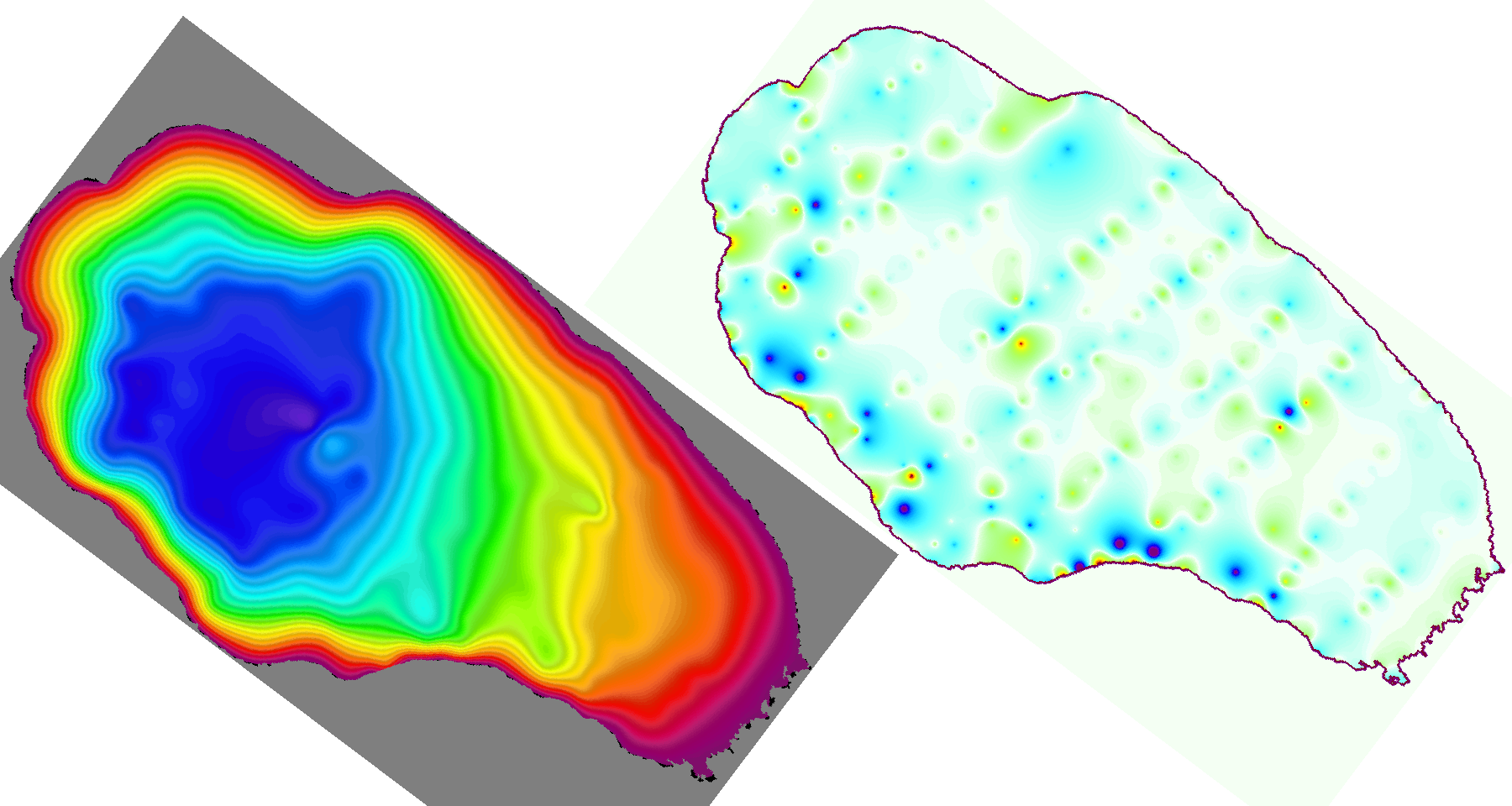

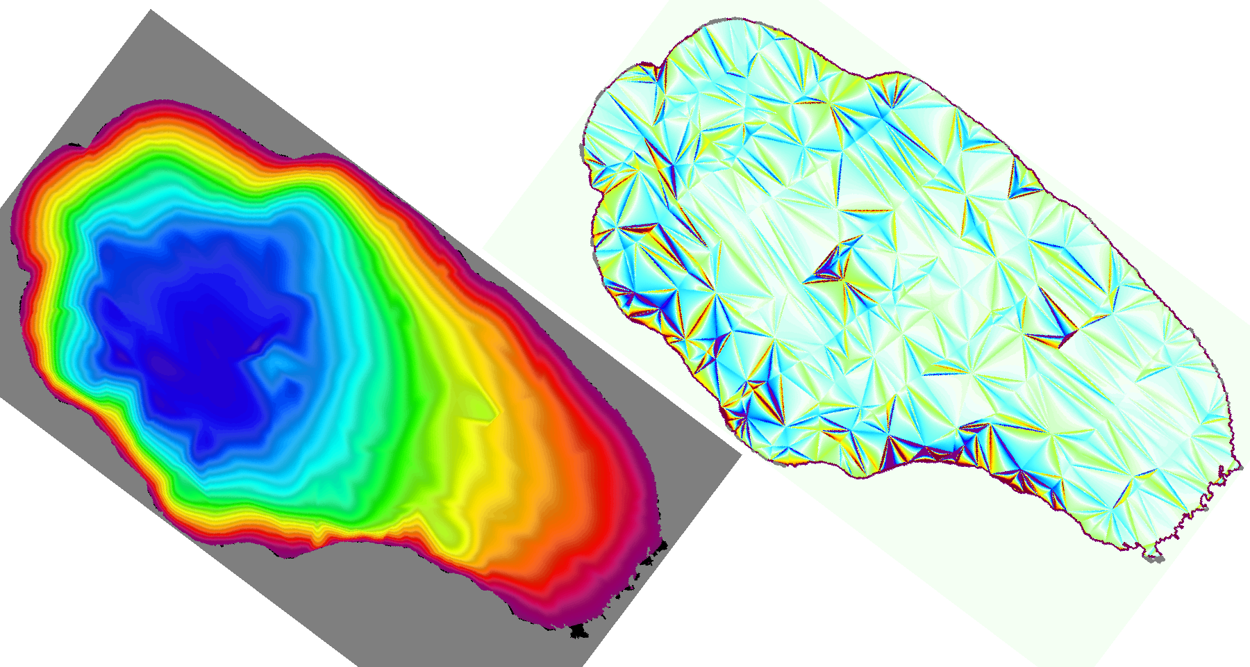

Cubic:
griddata(....,'cubic')
Field on the right is point-wise Laplacian computed from the field on the left. The scaling does not
matter, but the scale in exactly the same on all plots presented here. Computing point-wise Laplacian
is useful to expose discontinuities of first and second derivatives, and this way expose quality of
interpolation. Also it is possible to track down both resolution/placement of the initial source data,
as well as the algorithm itself (in unknown).
In the case of "linear" (see above) all what you see in triangulation itself, with color intensity of
line proportional to the discontinuity of first derivative - a kind of bent between to flat planes.
Here, for cubic case what you see on the right is a typical signature of griddata: it almost like
"linear", except that facets inside triangles are not perfectly flat.
On this suite https://www.mathworks.com/help/matlab/ref/griddata.html Matlab claims C2-continuity for
the "cubic" option for griddata. It is clearly not the case.

per line, N lines for N points on the shoreline). This operation is merely a file-format conversion.
This step is optional in sense that all ot does not matter how file "coastline.dat" was obtained,
and what is the original source of data. The contour should be closed. Optionally the outcome can
be visualized
Optionally you may plot it (black-and-white plots above were produced by this program)
       plot_coast_traj coastline.dat
which is compile-once-use-forever NCAR-graphics-based tool. It takes one or two arguments and produces
PDF file always called "file.pdf" (in addition to NCAR graphics library, it relies on Linux image format
conversion tools ps2epsi and epstopdf, which usually come with Linux distribution). This is purely for
visualization/checking purposes, does not affect any of the data files produced here.
       plot_coast_traj coastline.dat measured_bath.dat
which superimposes available data points onto coastline plot. See "file.pdf".
Produce merged coast-bathymetry file
    merge_coast_topo measured_bath.dat coastline.dat 150 merged_bath_coast.dat
After this operation the last file "merged_bath_coast.dat" contains bathymetry measured along the
trajectory of the boat (same as in measured_bath.dat) appended by the coastline where the bathymetry
is specified as zero. This is needed to make sure that interpolation algorithm (e.g., griddata_v4, or
else) has values at the coastline to lock on rather than extrapolate from inside (and end up with
meaningless values).
In addition to that this operation also perform averaging of measured points which are too close to
each other, hence potentially contain contradictory data causing interpolation routine produce steep
gradients. The third argument is minimum distance allowed specified in meters.
Once again, the outcome of this procedure can be visualized by command
       plot_coast_traj coastline.dat merged_bath_coast.dat
and looking at PDF file "file.pdf".
The next step is to compute raw bathymetry "hraw",
       biharm merged_bath_coast.dat roms_grid.nc
which is an alternative to running Matlab script "make_bathymetry.m" where griddata is set to option
v4 resulting in Sandwell (1987) biharmonic spline interpolation from sparse irregularly placed data
points. Either way, it takes the merged data file "merged_bath_coast.dat" and ROMS-style grid file
and produces raw topography "hraw".
After this moment your "hraw" is ready. Inspect it with ncview. Also useful is to compute Laplacian
and bi-laplacian
       hmask roms_grid.nc hraw
       laplace hmask.nc hraw
       laplace lap_hraw.nc lap_hraw
and inspect them with ncview as well. The first one gives a measure of smoothness of the interpolated field.
The second proves that hraw=griddata(x,y,z, xi,yj, 'v4') is, indeed bi-harmonic spline interpolation as
described in paper of David Sandwell, 1987: bi-laplacian is equal to zero except in data points, as delta
functions.
