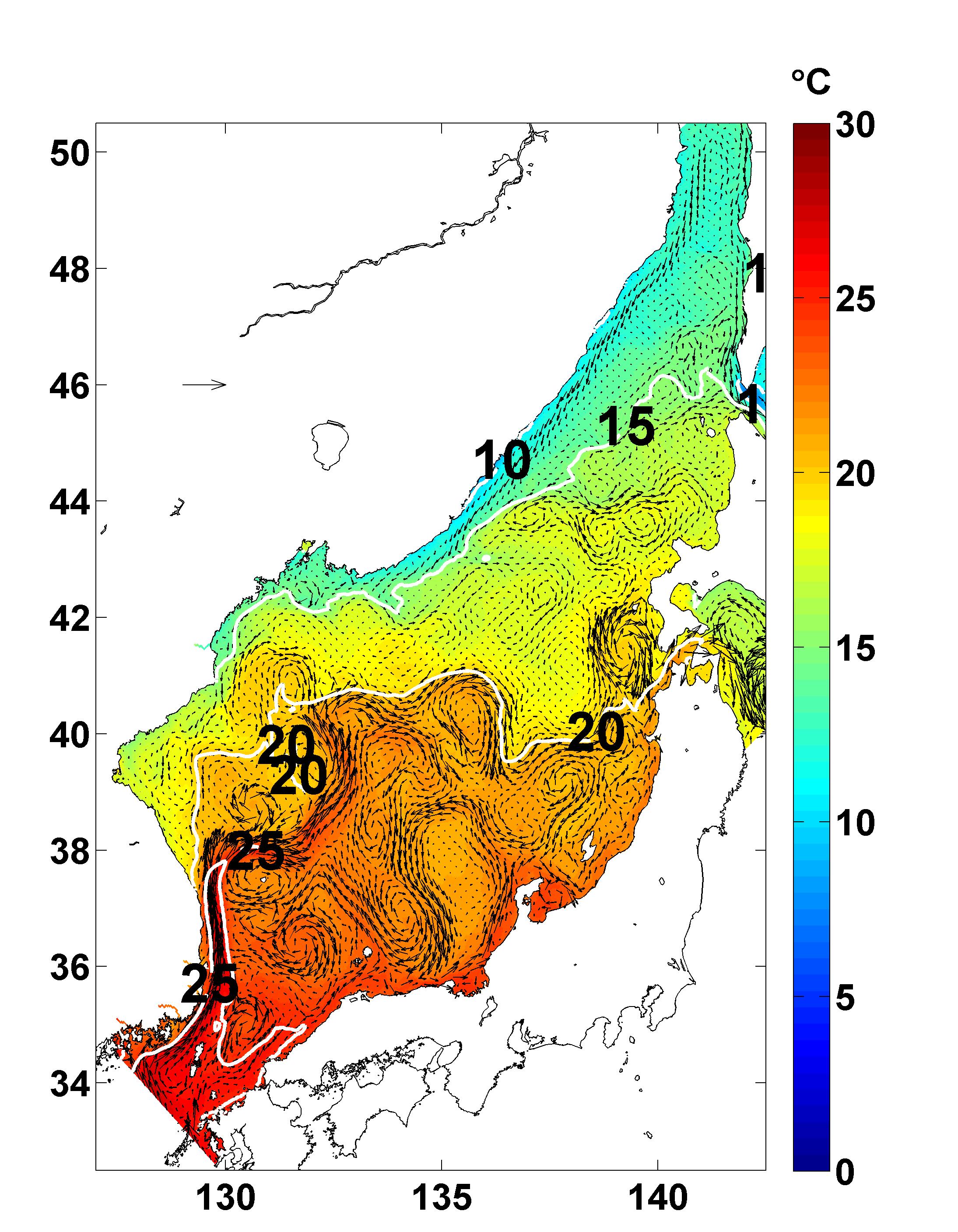

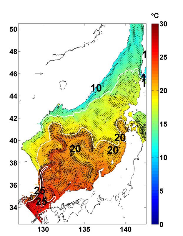

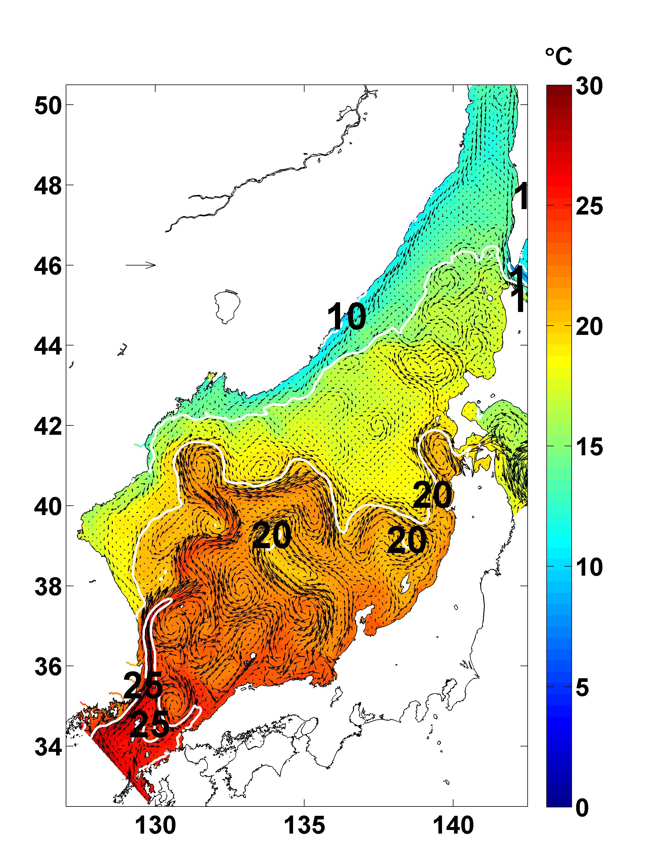

I have ran the PHY-BIO coupled model.
I faced the problem which is changed result whenever model-run although same condition.
Is it possible?
If possible, (1) I wonder why the gap is occurred (2) and how I will resolve it.
I asked a similar question previously and I guessed by non-linear term. Is it right?
Your definite answer is a great help to my argument.
For solution, I will try to change ERend and BioIter of parameter in ocean.in and bio_fennel.in respectively.
EX) ERstr=1, ERend=20, BioIter=20
If the above is correct, I have to know how the gap is decreased.
I'm sorry I have so many questions and thank to you and everyone in here.
p.s : added pictures are changed result although same condition. show to differ a isothermal line and current field.

One input have to one result in my think.
But whenever model-running, result is changed although only one input.
I know that same result don't be made by non-linear term.
I want to just decrease the gap at least for one input one result.
Therefore I want to convergence non-linear term.
I don't increased iteration number not yet.
and I don't changed any condition(initial, boundary, ATM forcing, parameter .. etc.)
and I don't use data assimilation.
Thank you always
