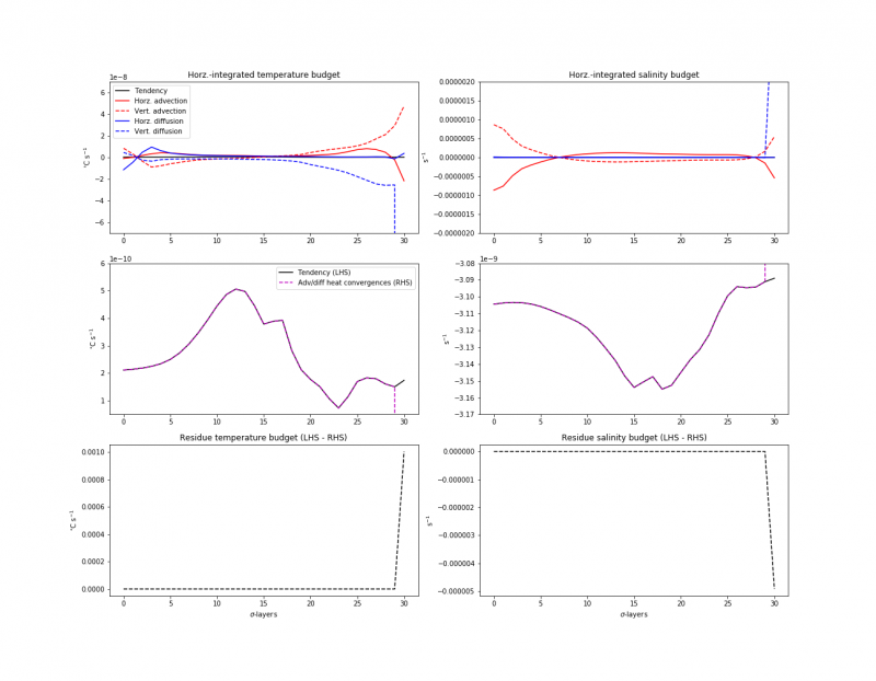

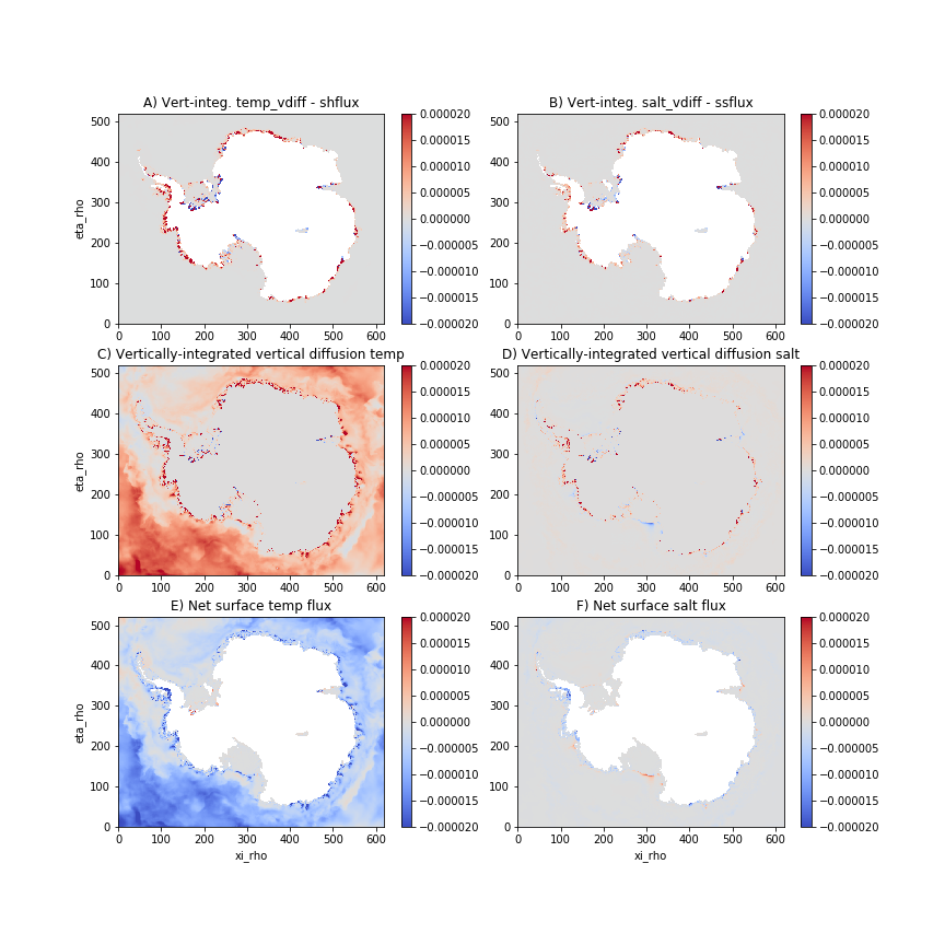

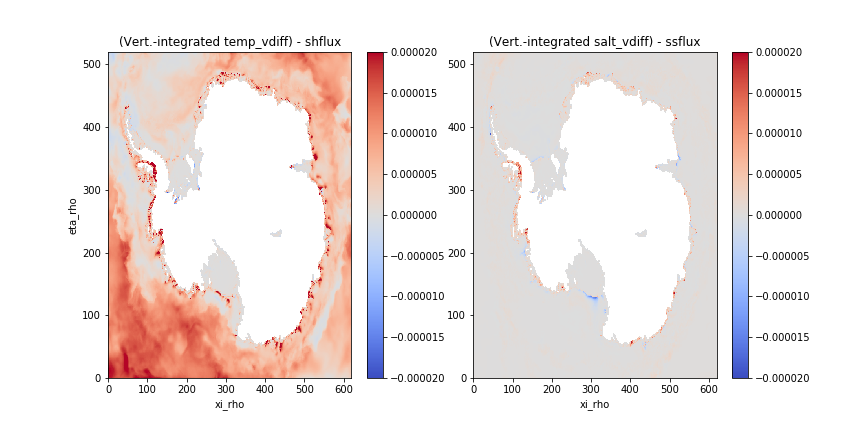

Re: Offline Heat Budget calculations from ROMS model output
I'm trying to have a closed temperature/salinity budgets using the diagnostics calculated via DIANOSTICS_TS. Assuming the temperature and salinity equations as defined by:
temp_rate = temp_hadv + temp_vadv + temp_vdiff + temp_hdiff + shflux
salt_rate = salt_hadv + salt_vadv + salt_vdiff + salt_hdiff + ssflux
Below the surface layer where the surface fluxes are not taken in account, I get a good match between the tendency (temp/salt_rate, LHS) and the ocean convergences due to advection/diffusion (RHS), see figure attached for horizontally-integrated budget over the model domain (bottom panels show the residue between LHS and RHS).
However, there is a significant mismatch in the upper layer. I divided the net surface heat flux (shflux) by Cp x rho to convert from W m-2 to degC m s-1, while for net surface salt flux are already in m s-1. Either accounting the surface fluxes (dashed blue line in the top panels) or not (magenta dashed line) don't help to close the budget (still order of magnitudes larger than the ocean convergences). Should I account for the thickness of the upper layer to convert degC m s-1 to degC s-1? The ocean_dia.nc file indicates the tendency diagnostics are in degC s-1, is that correct?
I also tried to closed the budget by integrating vertically the temp_vdiff term and comparing with the surface fluxes, again unsuccessfully (see second figure attached, annual mean). I used monthly avreaged diagnostics (for both avg/dia) in these calculations, and this is a circumpolar model of the Antarctic with 10km horizontal resolution (31 sigma levels). I understand that the time average interval might affect the zeta and the offline calculation of the layer thickness (used here to integrated the vertical diffusion component), so I'm running the model again to save these diagnostics with 5-day interval. Any other suggestion on what might be potentially wrong?
Fabio
Fabio

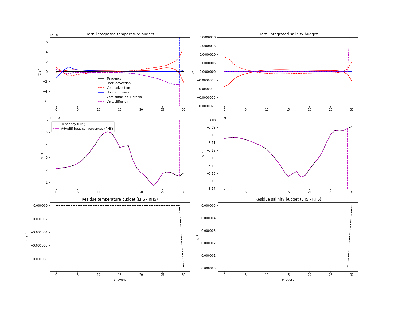

You shouldn't have shflux here because it was applied as the surface boundary condition to temp_vdiff and so is already included in the vertical divergence d/dz*(K_v*dT/dz) (i.e. shflux/(Cp*rho0) = K_v(dT/dz at z = zeta; notice the division is by parameter rho0 not the model in situ density).temp_rate = temp_hadv + temp_vadv + temp_vdiff + temp_hdiff + shflux
If you vertically integrate temp_vdiff = d/dz*(K_v*dT/dz) between the limits z = -h and z = zeta then you should simply get K_v*dT/dz |z = zeta minus K_v*dT/dz |z = -h which is shflux/(Cp*rho0) minus 0.
You are correct that the diagnostic terms are in degC s-1. The units of shflux/(Cp*rho0) are degC m s-1 because of the vertical integral.
I don't know why your vertically integrated temp_vdiff in degC m s-1 does not balance shflux/(Cp*rho0) but you are correct that it should. Make sure you used the Cp and rho0 that ROMS assumes.

I have used rho0 (not in-situ rho) and heat capacity obtained from mod_scalars.F. I figured out an error in my dz calculation, now obtained by:
By fixing the layer thickness calculation, the difference between the vertical integral of vdiff and shflux got closer (especially out of the continental shelf), but still there is a mismatch near the Antarctic coast (see fig. attached, top row).
This model includes the ice shelf module, so I'm wondering if this has anything to do with ice shelf - ocean fluxes not properly diagnosed. I will look further into this in the ice shelf code.
However, even if the vertical integral of vdiff and shflux get a perfect match, I'm puzzled by the plot of the horizontally-integrated tendencies. If the surface fluxes are included in vdiff, why the temp_rate and the sum of all other terms (temp_hadv + temp_vadv + temp_diff + temp_vdiff) do not match? If the surface fluxes at the upper layer are much larger than other terms (hdiff and advection), that shouldn't reflect in the temp_rate? I'm including a new version of the previous figure here without include the surface fluxes in the budgeting (so considering temp_rate = temp_hadv + temp_vadv + temp_vdiff + temp_hdiff).

Your plots seem to indicate the mismatch in your budgets is only at the Antarctic coast. So that does rather implicate the ice shelf as a possible issue - perhaps some term not added to the diagnostics, or that needs to be separately explicitly taken account of in your analysis.

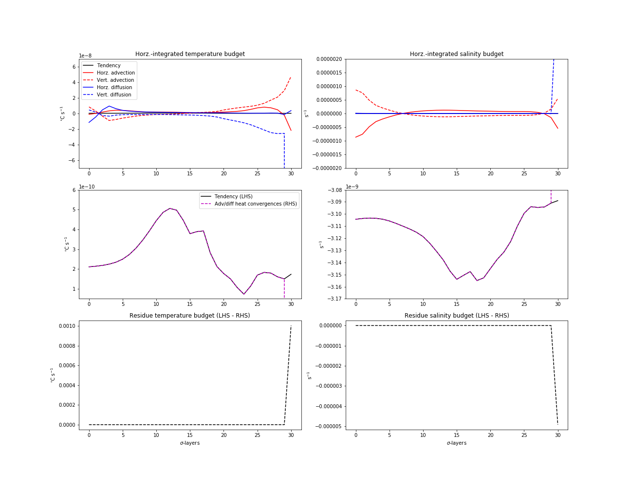

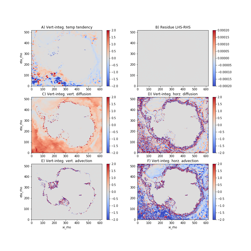

Hi John,
thanks for your insights. I hope to find out what's missing in terms of the surface fluxes soon - I will keep it posted here.
Regarding the horizontally-integrations terms, my northern boundary is not closed so I wouldn't expect this integral to be zero. What I was expecting is that temp_rate (LHS) and advection+diffusion (RHS) balance each other at every layer. That occurs for every layer except the upper one.
So I did plot the vertically-integrated terms (attached), in an attempt to reproduce the analyses you did in your 2006 JPO paper (fig. 10), but annually averaged. As we know, the vertical diffusion term when depth-integrated should be equal to the net surface flux (panel C below). That flux entering or leaving the model domain should be transported by other terms via vertical/lateral fluxes (advection and diffusion), and result in a temperature/salinity tendency (temp_rate/salt_rate, panel A). The panel B shows the vertically-integrated LHS minus the sum of the RHS terms (C, D, E, F), which has a residue a few order of magnitude smaller than the individual terms (O(10^-5) degC/day). I think that makes sense and indicates the model has a closed budget, would you agree? So the upper layer is not direct balanced in the horizontal integral because the surface fluxes enter the ocean in that layer but are distributed in the vertical (and lateral) by individual components of the temperature/salinity fluxes - but they do balance when all terms are depth-integrated.
Fabio
Fabio
