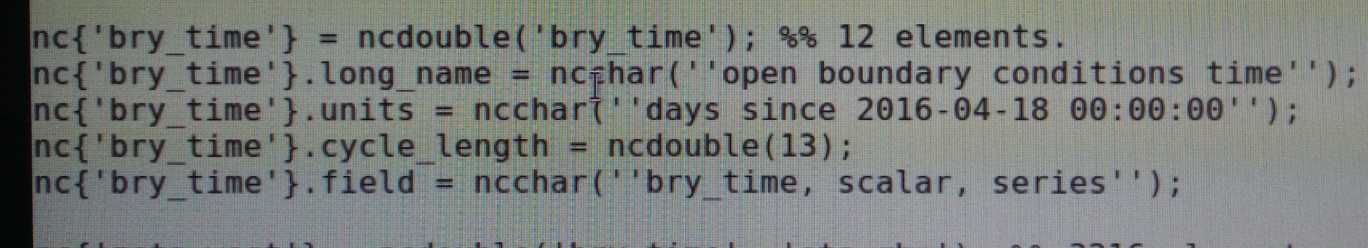

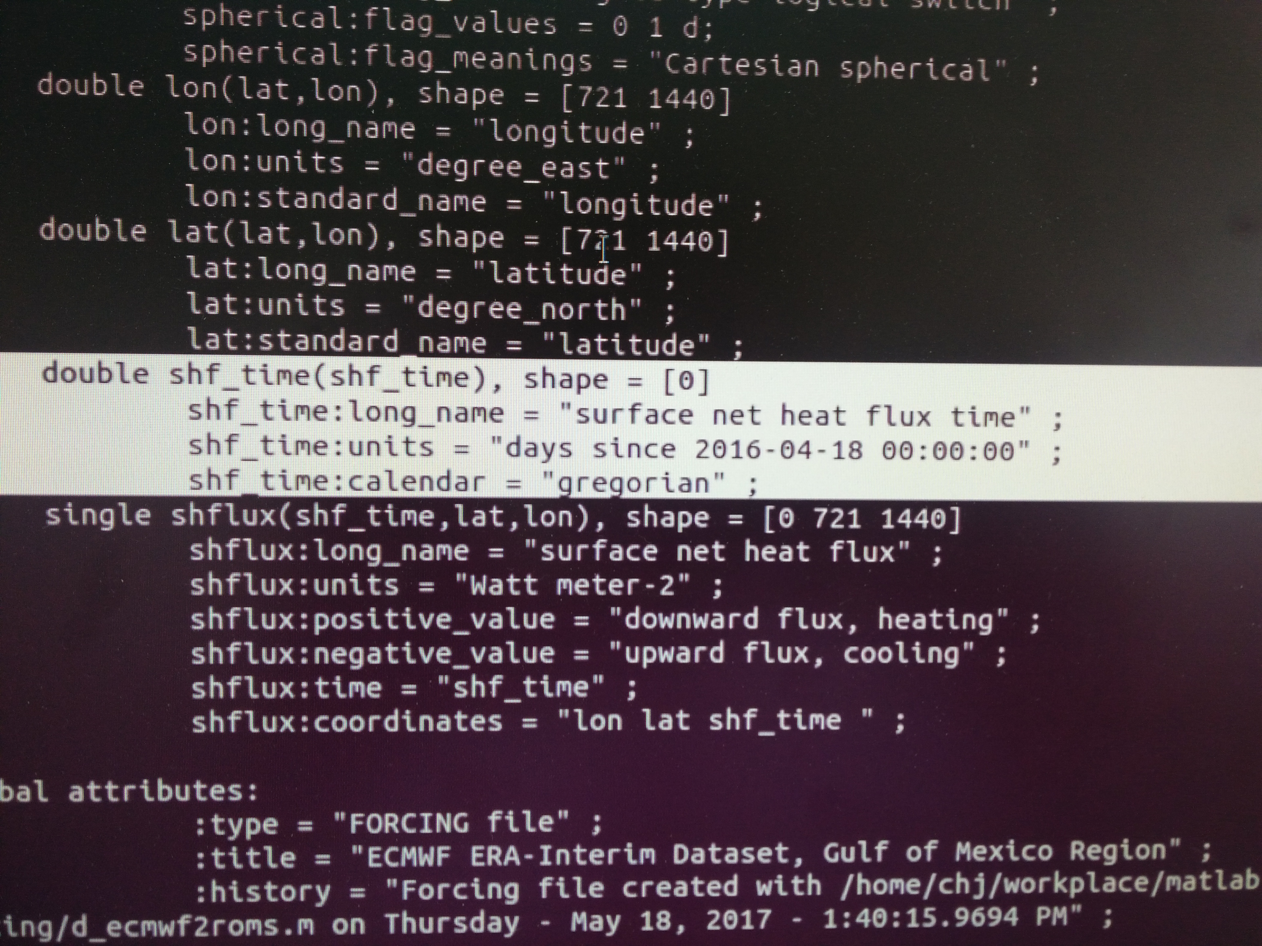

I post several pictures as follow which indicate how i defined the attribute of ocean_time,bry_time,forcing_time in my netcdf input files.As you said, i should make this several time be consistent. whether i define the 'units' of 'ocean_time' to 'second since 2016-04-18 00:00:00' or not?i think it's maybe a mistake due my careless.

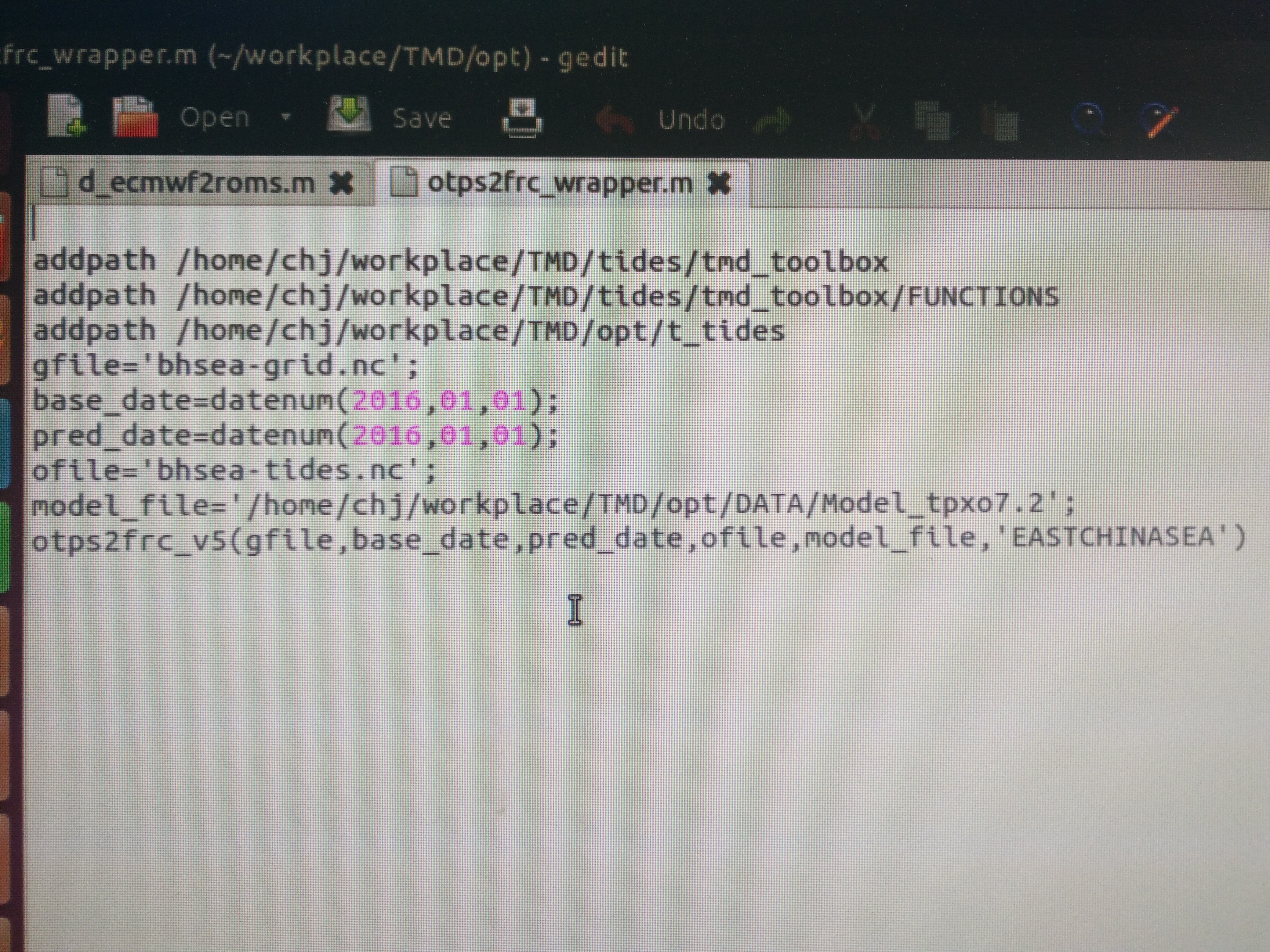

Whether The 'base_date'(2016-01-01) in picture 'tide_base_date.jpg' is my tide origin time? if the answer is 'yes',i think i should define TIDE_START= -108.0d0 (tide base time - time_ref).
The values of time(including ocean_time,bry_time,forcing_time) are all set from 0. So i prepare to set DSTART=0.0d0 and TIME_REF = 20160418.0d0. I don't know whether my thought is right or not?
