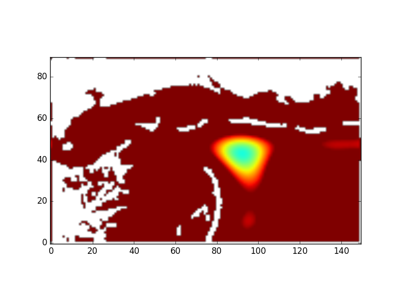

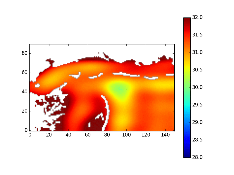

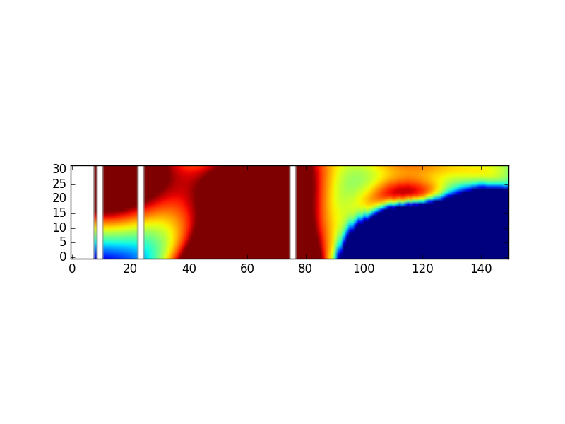

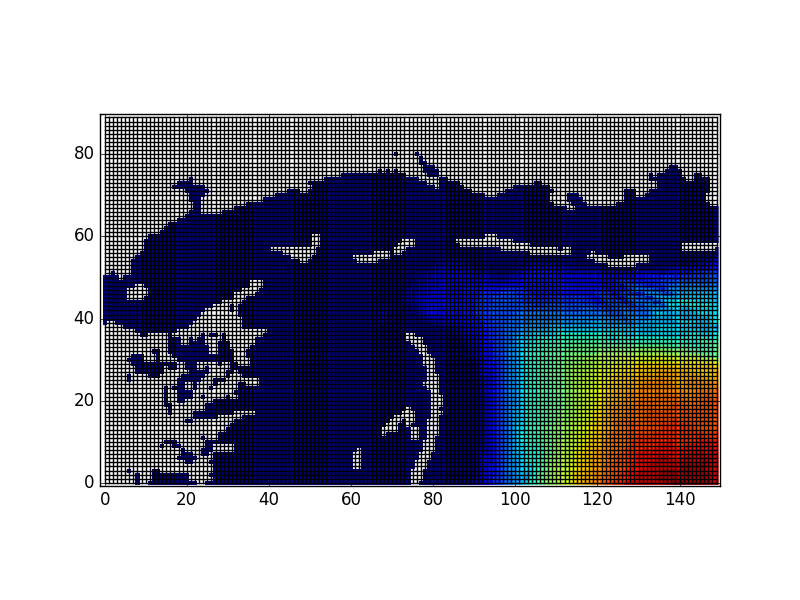

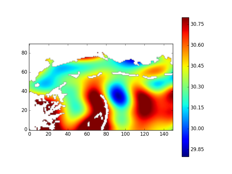

I have been working on a model, but the output shows that my boundaries are swapped (north is south, east is west, etc). I have been unable to figure out what the root of the problem is whether it be a misspecified grid, a bad setting, something installed incorrectly, etc. If you look at my input files (temperature in the images), everything looks ok to me.
grid:
climatology:
southern boundary (vertical cross-section):
ocean_his.nc (temperature):
Notice the water in the output image along the northern and western borders. I have latitude and longitude ascending in all my input files from an ncdump. Additionally, looking at the directional tracer variables (e.g 'temp_south'), the boundary information is correct. Everything in varinfo.dat looks as it should for the boundary variables. Does the order that the variables are in your boundary file matter? It seems if the data is associated with the correct variable name, things should work ok. I'm really at my wit's end, and I was hoping to include an example model in an upcoming presentation in three weeks. Is there a setting somewhere that I am missing that could cause this? I'm sure whatever mistake I have made is an obvious one, but I understand that having someone else figure out exactly what I did might not be so easy. Does anyone know why my boundaries are backward?

#11 Unread post by JDTilley »
