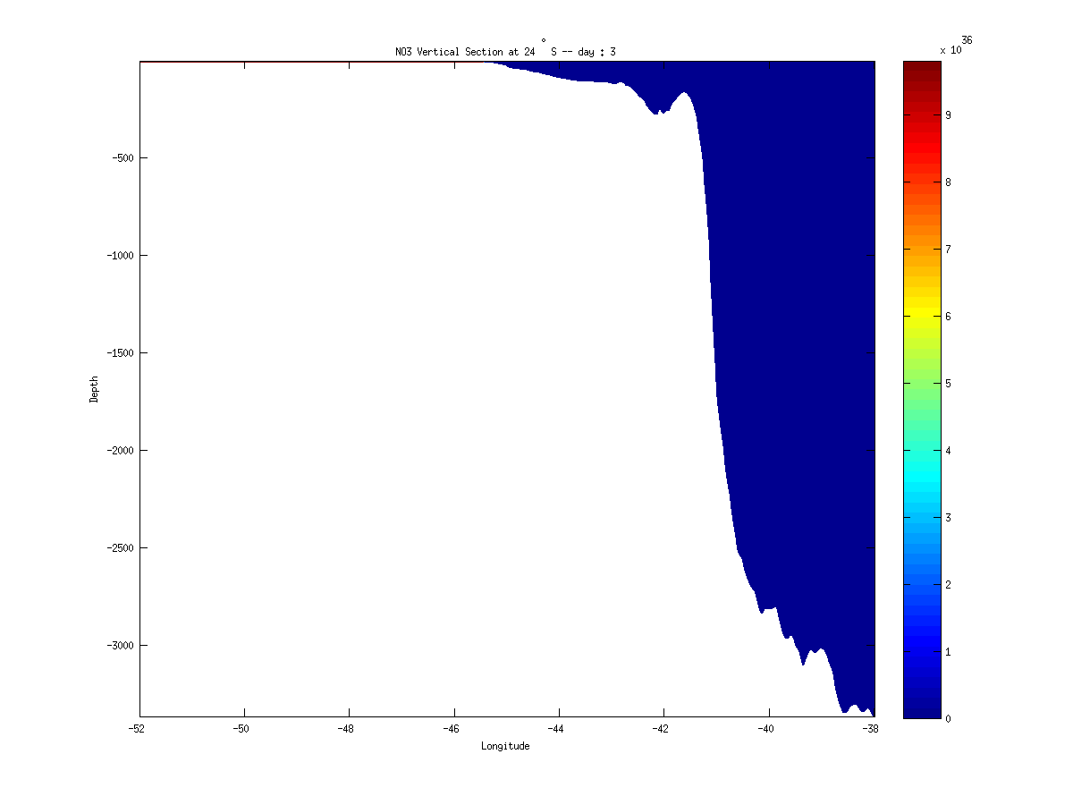

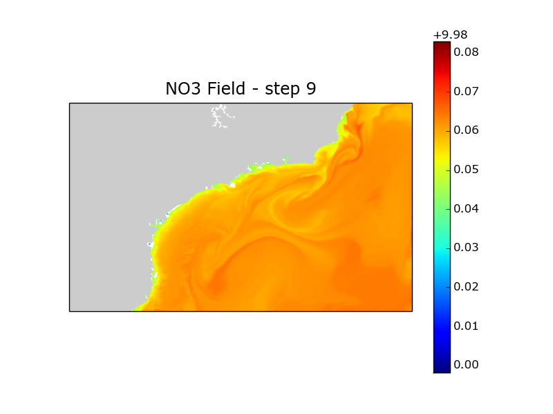

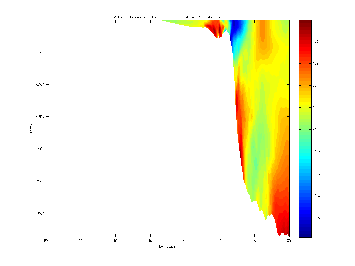

I am studying the response of phytoplankton community to eddy activity in Brazilian Southeast coast.
My hydrodinamic model is working fine, the problem happens with the npzd_Powell model. I made tests with both homogeneus initial conditions and idealized npzd fields. There seems to be no response or interaction between the npzd compartments.The vertical structure for physical variables works, but for the biological parameters not.
I made a run using the upwelling testcase with npzd_Powell active and everything seems to be fine, with instant response from the compartments.
Is there something else to set in the CP or .in for the coupling works?
I'm sending the .h and .in images and some plots.

First, you should find out why the colorbar for the first two vertical slice plots wants to extend to 1.e37. Are those points in the land mask?

Thank you very much for the replies Kate and Wilkin.
Kate, there is no land mask on the biological initial fields, I'm working on this.
Wilkin, I don't know why this is happening. I used to run my experiments in another machine, using MPI, and the minimum grid-spacing was fine. Now, im using OpenMP in a new machine, but I know people who use OpenMP as well without problems. This could be a problem?
