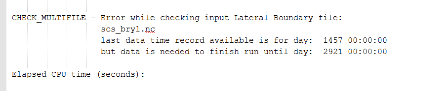

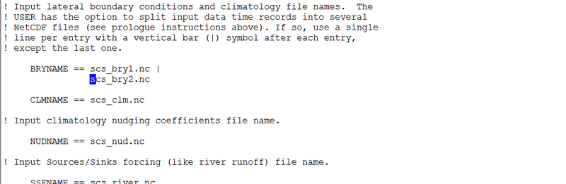

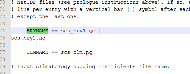

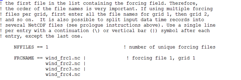

My bry file and wind force file are larger than 2G,so I split them according time records.
I split bry file into 2 nc files and wind forcing file into 4 nc files.

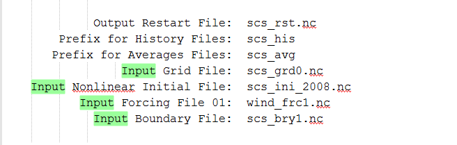

I do not know why the model couldn't read the 'scs_bry2.nc'.
When I check the output.dat ,I also could not find 'scs_bry2.nc' 'wind_frc2.nc' 'wind_frc3.nc' 'wind_frc4.nc' in input files.
Is there something I missing?

I am obtaining the same error as xwbin. I am trying to run a simulation forced with wind, tides and a sea level imposed at the boundaries. If I force the model only with tides and wind, it run without problems, but when I add the bry file, it give me the error:
CHECK_MULTIFILE - Error while processing Lateral Boundary multi-files:
data does not include initialization time = ***** 00:00:00
***** 00:00:00 ***** 00:00:00 INPUT/mysimulation_bry.nc
CHECK_MULTIFILE - Error while checking input Lateral Boundary file:
last data time record available is for day: ***** 00:00:00
but data is needed to finish run until day: ***** 00:00:00

Any comment or suggestion will be really welcome.

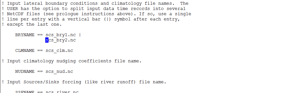

Re: question follows after splitting bry and wind force file
ROMS is quite picky about the format of the file. Do you have tabs in the ocean.in? I suggest getting rid of the comment on the line of your first forcing file too. ROMS will ignore comments where the "!" is at the start of the line.
Thanks for your help,there are no tabs or any comments as attachments showing.I only modify .in file,are there any other files i need to modify?kate wrote:ROMS is quite picky about the format of the file. Do you have tabs in the ocean.in? I suggest getting rid of the comment on the line of your first forcing file too. ROMS will ignore comments where the "!" is at the start of the line.
- frc.png (10.23 KiB) Viewed 12828 times
- bry.png (12.92 KiB) Viewed 12828 times
Not unless you have a stations file or something. Did you try it? What happened?
Hi Kate,kate wrote:Not unless you have a stations file or something. Did you try it? What happened?
Really thank you for your patience!I find the answer with your help.You remind me that the format is important.It works after I checking the bryname format as well as frcnameformat and deleting a blank line as the attachments showing.
- after deleting
- bryfixed.png (4.05 KiB) Viewed 12809 times
- before deleting
- bry.png (12.92 KiB) Viewed 12809 times
Was it a space or a tab that caused problems? I'd get rid of any tabs if you have them.
