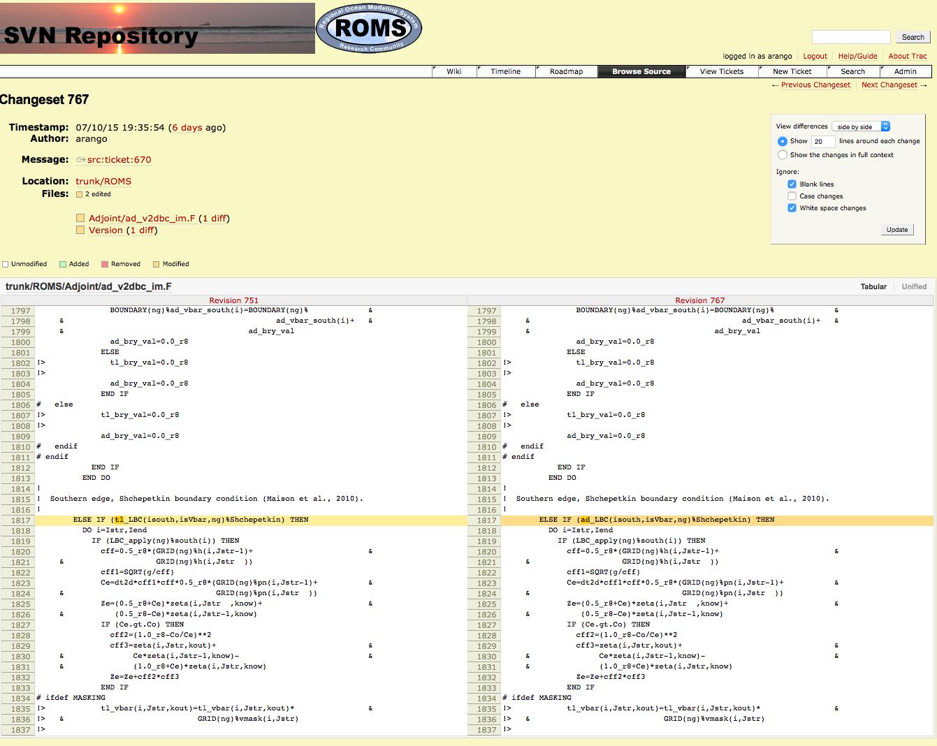

I don't know what are you talking about. I checked the code and it already have that correction! I think that you need to update. As you see below, ad_v2dbc_im.F already have the change as shown on :arrow: trac for Revision 767:

Thanks a lot for the update. My post (Jul. 9) is before the update (Jul.10). That's the reason. Thanks.
