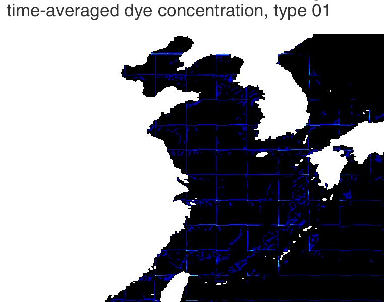

In my application in Eash China Sea using ROMS src 766, there are weird results for tracer mixing (see the attached picture), where CLIMA_TS_MIX is turned on for salinity and temperature, but turned off for tracer. The bug resulted in this wrong result is that the tracer mixing are wrongly calculated by t(i,j-1,k+1,nrhs,itrc)-tclm(i,j-1,k+1,itrc) when itrc is larger than 2.
I checked the code and found bugs in t3dmix2_geo.h, t3dmix2_iso.h, t3dmix2_s.h, t3dmix4_geo.h,t3dmix4_iso.h t3dmix4_s.h,ad_t3dmix2_geo.h and so on. In my configuration, i have set LtracerCLM == T T F and LnudgeTCLM == T T F ( temperature, salinity, inert) in my *.in file, which means the tracer mixing should not be dealed with t-tclm, however in mixing subroutine such as t3dmix2_geo.h, the tracer mixing is still calculated by t-tclm when itrc is equual to 3.
I have fixed these bugs in these subroutines. And the tracer is properly mixed.

Thanks for the patch! It's scary when you see the tile boundaries like that.
