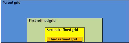

Dear
in my test, nesting will occur between near-shore and offshore. and i have Multiple Refinement Sub-Class grids. would you please tell me that
1-is it possible to define another minimum depth (hmin) for first Refinement Grid from parent grid? If yes, how?
2-is it possible to define another minimum depth (hmin) for second Refinement Grid from first refined grid? And so on...
Cheers
pooran
Cheers
pooran

sorry I cant completely catch nestlayers and gridsinlayer. Would you please help me with second post's figure as an example: should it be set as:
Ngrids= 4
nestlayers=4
gridsinlayer=1 2 3 4
2-if there is two child grids and one parent (in mentioned figure) then is it true to set:
Ngrids= 3
nestlayers=3
grids in layer=1 2 3
Ngrids= 4
nestlayers=4
Ngrids= 3
nestlayers=3

Re: nested grid layer and min depth
Sorry but I become grateful to know that for figure in second post is it true to set Ngrids, nestlayers and gridinlayer flags (in ocean.in file) like bellow?
Ngrids= 4
nestlayers=4
Sorry but I can’t find any test to find my answer therefore I need your experience for my set up(if it is possible)
Thanks for any reply
Ngrids= 4
nestlayers=4

- Posts: 1387
It has been mentioned several times in this forum that more than two nesting layers for refinement grids still need some debugging for NestLayers > 2. Your configuration with four grids is very poor and ill-posed in my opinion. Obviously, you need to gain more experience with nested grids and ocean modeling. A configuration like the one in your diagram will be subject to a lot of new physics due the ratio of refinement between the coarser and the finer grids. If you require such a high resolution in such a small coastal area, you started with the wrong resolution for the coarser grid
The two-way interaction between four grids will yield a lot of high-frequency contamination between grids.
I will recommend for you to start simpler. Use two grids and gain more experience with ROMS and numerical modeling.
