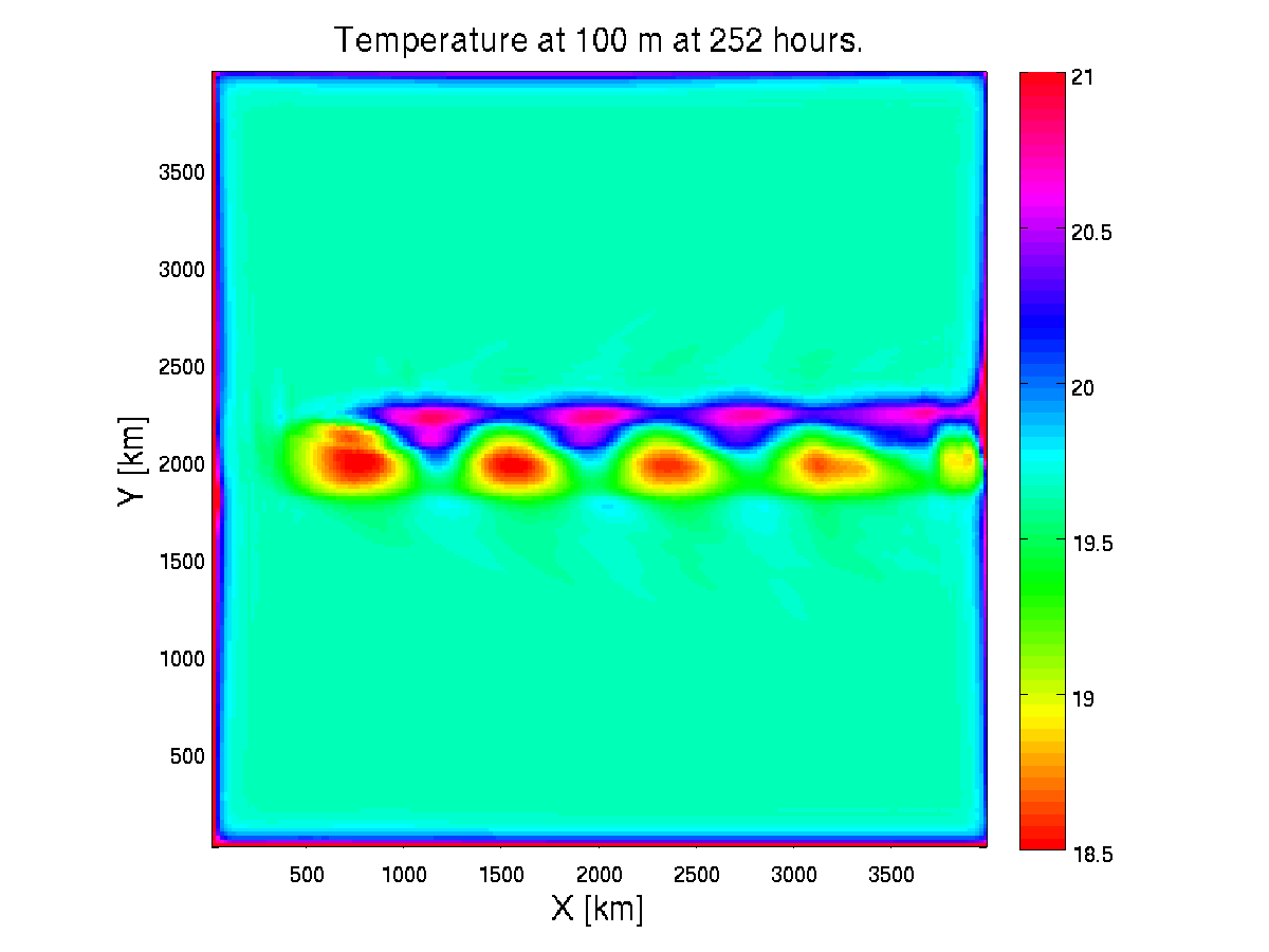

I'm new to ROMS and I'm using ROMS Agrif right now. I'm running a very idelized simulation of a hurricane passing over a square flat basin on a f-plane. All the fluxes (heat, fresh water, bottom fluxes...) are set equal to zero, a part from the surface momentum flux, which is defined analytically.
On the North and South boundaries there's a wall, while the basin is defined to be periodic in the East-West direction.
The problem is that it seems that there's downwelling along all the four boundaries, starting from the east part of the North and South boundaries and then propagating everywhere (but only in a pretty thin layer close to the boundaries).
Attached there are few frames of an horizontal section of the temperature at 100 m depth.
Does anyone have any ideas where this problem could be coming from? I can provide more info and files if that would help. Any suggestions would be very much appreciated!
Re: Problem with periodic boundary condition
Clearly, you don't actually have periodic boundaries. I don't know how AGRIF decides these things, but if it is compiled in, you might need a "make clean" and a fresh build. Can you see the code after cpp has gone through? You can check at that phase for the periodic code.

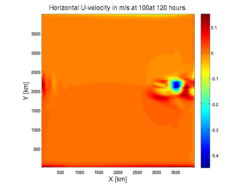

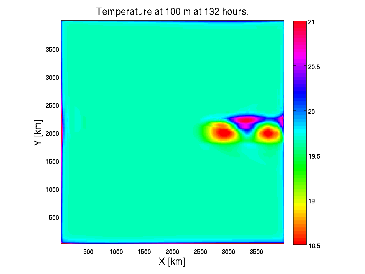

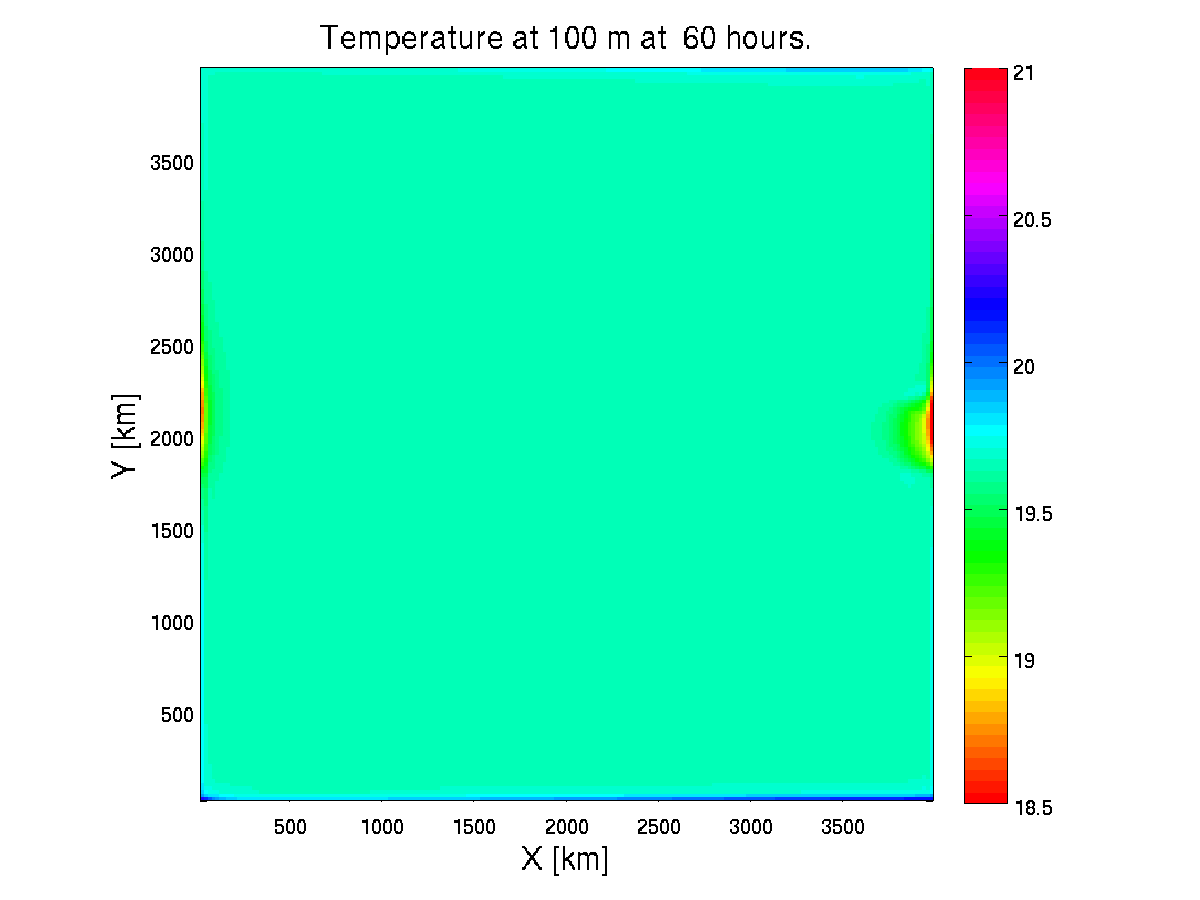

I understand that it seems that there's no periodicity in the EW direction in the pictures that I've attached, by here I post two other pictures (from the same simulation), where it is more evident. The first is the horizontal u-velocity field at the same depth (100 m) and the second is again the temperature field, but at an earlier instant.
Moreover, it seems that in the code the periodicity is defined and in the .out file, the list of cpp flags activated contains the EW_PERIODIC:
