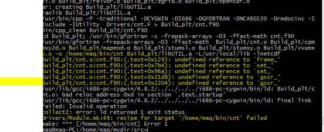

i have a trouble when i install plotting package. when i issue the make command, there comes an error as follows
could anyone help me!

I think, your problem is due to NetCDF package,
you have to ask the admin where is NetCDF lives
and load it before the plotting package installation

You get this problem if you only install the netcdf c library. Please check the following post for more information:
viewtopic.php?f=31&t=2715

no,i have installed gfortran too
linzhenhua wrote:You get this problem if you only install the netcdf c library. Please check the following post for more information:

Please note that gfortran is a fortran compiler, what you may need is netcdf fortran library.

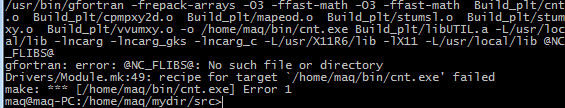

i use the gfortran compiler, the makefile and CYGWIN-gfortran.mk are as follows. what's wrong with it.

But i can compile the upwelling test successful

thank you for your help!! the question has been solved!
