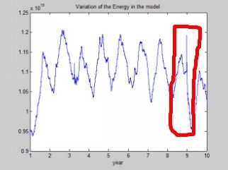

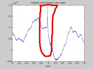

I have a trouble with RESTART even I defined PERFECT_RESTART.
For the first run, it ended in 930240 step, the screen output like this
 930238  3229 23:50:00  2.343559E-03  2.323374E+04  2.323374E+04  4.688070E+17
         (0389,498,18)  6.291085E-03  3.352070E-03  1.438732E-01  2.145083E+00
 930239  3229 23:55:00  2.343540E-03  2.323374E+04  2.323374E+04  4.688070E+17
         (0389,498,18)  6.287961E-03  3.355134E-03  1.438942E-01  2.145129E+00
 930240  3230 00:00:00  2.343522E-03  2.323374E+04  2.323374E+04  4.688070E+17
         (0389,498,18)  6.284754E-03  3.358239E-03  1.439150E-01  2.145175E+00
      WRT_HIS   - wrote history  fields (Index=1,1) into time record = 0000070
      WRT_AVG   - wrote averaged fields into time record =             0000035
Terminated
Then the model outputed a restart file in step 930240, I restart the model from that step with the restart file, but got the screen output from the restart run, as follow,
   STEP   Day HH:MM:SS  KINETIC_ENRG   POTEN_ENRG    TOTAL_ENRG    NET_VOLUME
 930240  3230 00:00:00  2.343522E-03  2.323367E+04  2.323368E+04  4.688070E+17
         (0200,050,02)  3.130760E-02  3.470927E-02  0.000000E+00  2.145175E+00
      DEF_HIS   - inquiring history file, Grid 01: np8_his_0009.nc
      DEF_AVG   - inquiring average file, Grid 01: np8_avg_0009.nc
 930241  3230 00:05:00  2.345268E-03  2.323367E+04  2.323368E+04  4.688070E+17
         (0389,498,18)  6.270005E-03  3.394958E-03  1.439145E-01  2.144243E+00
 930242  3230 00:10:00  2.345296E-03  2.323367E+04  2.323368E+04  4.688070E+17
         (0406,495,30)  3.082030E-02  4.629990E-03  4.852346E-01  2.143983E+00
 930243  3230 00:15:00  2.345144E-03  2.323367E+04  2.323368E+04  4.688070E+17
         (0401,494,30)  2.442397E-02  8.826006E-03  4.320690E-01  2.143462E+00
I have got so much differences for the variables Cu, Cv, Cw between the first and restart run in step 930240. I also upload two figures about the variations of the total kinetic Energy (KE) with model time. It included a too big jump after the restart step.
What is the reason for that? How can I fix it?
the variations of the total kinetic Energy in model domain

Hi Kate or anybody,
Can you give me any clue for this problem? I really need your help.
Thanks.
Re: big jump occured when restart
#5 Unread post by kate »
I would check to make sure that PERFECT_RESTART really is giving a perfect restart for the options you have chosen. I see you are getting a warning about the little-used SMAGORINSKY options. Perhaps PERFECT_RESTART doesn't work with them.
In other words:
* Check to see if PERFECT_RESTART behaves as advertised by running some short tests.
* If not, fix it.
* Check your energetics again.
I should add that step two can be accomplished by running two debugger sessions, one in a restart case, one in a case run from the beginning. Or perhaps print statements of the fields in question if you get lucky in guessing what they are, perhaps after seeing what differs in step one.

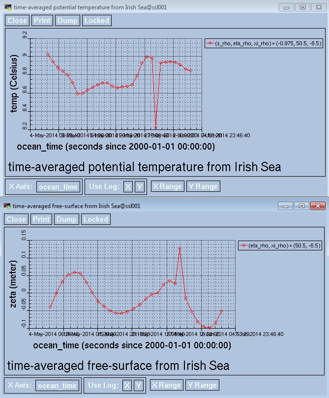

#8 Unread post by osua72 »
I am running into a similar problem, I'm trying to run a model for a year, outputting both hourly data and daily averages. Because of the time-limit on the super computer I need to restart the model every three days which I do using NRREC == -1. I'm running with PERFECT_RESTART defined and the results in my history file seem fine, however in the averages files I get a spike when the model is restarted and was wondering whether anybody could shed a light on why this might be:
