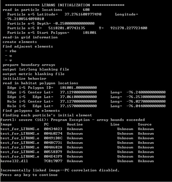

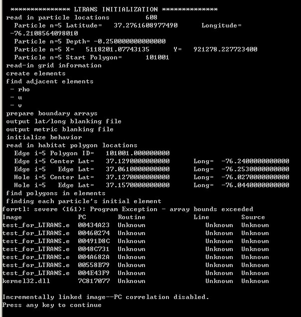

Re: LTRANS: Larval TRANSport Lagrangian model
I successfully compiled LTRANS v2 using the test case. But when I ran LTRANS.exe, the screen printing stoped as follows without any error message. Can anyone please help me with this problem? Thanks in advance
The above problem I met occured during the use of Linux and ifort. Then I tried to run the test case under Windows and VF, and I got the following result. How to tackle this problem ? Thanks very much.Yomi wrote:I successfully compiled LTRANS v2 using the test case. But when I ran LTRANS.exe, the screen printing stoped as follows without any error message. Can anyone please help me with this problem? Thanks in advance
Rebuild with bounds-checking enabled, maybe try a few different compilers, to establish the statement and array reference that triggers the bounds violation. Then use your preferred debugging technique (mine is WRITE statements inserted into the code) to establish why this is happening.
This being larval tracking code, you might suspect a larva has moved outside the domain. But that's just a guess.

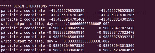

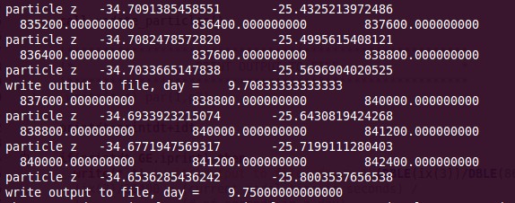

I tried to use the LTRANs version 2 for my ROMS application. It works great if I release the particles on the surface. However, I found something weird of the model outputs if I released the particle in the subsurface layer. In the attached figure, the depth of the first particle moves immediately from -40 m to -1 m at surface. I tried many different setup and gain the same results. Does anyone have the similar experience here. Please help me out here.
It looks like a bit of digging into the particle initialisation code might not go amiss!
I added the test command because I found something wrong in the outputs. The interesting thing is I solved the problem by adding another command (see attachments).
I don't know exactly what happens here. Seemingly, adding commands to print out variables on the screen can totally change the model results. The original code, in my experience, gave me unrealistic vertical motion of particles. If somebody has the same issue, I hope my post would help.
I trust you are running with bound checking, as I suggested a few posts ago.
When adding a line of code changes the results, it usually means you are doing something a bit dodgy, and writing or reading outside the bounds of an array is definitely dodgy.
Thanks for your reply. The good side is it actually solved my problem. The trajectories of these particles look pretty smooth and realistic. So without further debugging of the codes, I would just use it as a temporary solution.
Actually, adding a write statement and having it change the results smells like an optimizer bug. You can pursue this by turning off optimization (and adding bounds checking) to see what you get then.

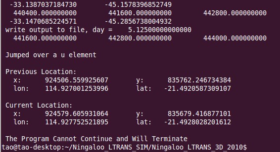

Thanks, Kate. I will have a look. There is another issue coming with the code. It is not a bug but very annoying(see the figure). somehow the particle jump over something and the model stop to run. I mean is there a way to turn this thing off or just let the particle stop if it passed through certain elements.
Hi simion1232006,
I have been using LTRANS for a while for a number of different purposes and have trouble-shooted (shot?) a lot of issues.
I suggest that you decrease the idt value, internal particle tracking time step (s), to prevent the particle skipping through a computational cell.
That should resolve the issue.

What does it mean that the particle jumped over u (or v or rho) element? And why do I get "**********" seconds instead of an exact number? '
(My LTRANS.data file is attached.)

wolfegg wrote:Hi all,
I got a weird ErrorLog.txt when I am using the LTRANSv2b to simulate the pathway of passive floats.
Particle 228 jumped over u element after ********** seconds
Particle 228 jumped over v element after ********** seconds
Particle 258 jumped over u element after ********** seconds
Particle 166 jumped over u element after ********** seconds
Dan
Further, I found that most of my floats did not move at all. I released 1612 floats to my domain. Does the LTRANSvb2 have a maximum capability in terms of float quantity?
Dan
