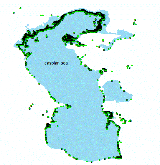

my requested hydrography data (for Caspian sea) have been provided from GEBCO (1 minute resolution).its minimum depth is 1 m and also some points have zero value (attached picture show these points). with regard that for generating grid, there should not be zero value, eliminating them that located in the sea or near coastline, will arise problem in future steps?
what is your recommendation about solving it?
thanks in advance for receiving your experiences
cheers
fereshte
Caspian sea area. points show position of points with zero value
caspian sea.GIF (44.5 KiB) Viewed 10976 times
Re: bathymetry values
#9 Unread post by kate »
Are you using WET_DRY? If not, you need to clip the bathymetry to be greater than or equal to some hmin larger than zero.

#10 Unread post by fereshteh »
dear kate
thanke so mush
yes, because my domain has land as well as sea, i will use WET_DRY option.
so with this option can clip bathymetry value.is not it?
thanks again
cheers
fereshte
#11 Unread post by kate »
I haven't ever really used WET_DRY, but hope to soon in a new application. Anyway, what happens if you try it?
