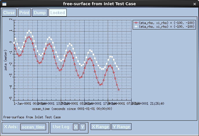

The Inlet test domain is 14 kilometers from south to north, so this expression will produce far more vertical displacement in the water level over time than is realistic. As intended - I want to watch what's happening as the tides and wind work together. Here is a plot of the free surface zeta in two places:
Inlet test: wind and tide
The lower red line is the northern (tidally forced) boundary, and the upper white line is the southern (free) boundary. We have a tidal signal superimposed over a drop in the water level. I can see that since the two lines are gradually diverging, the wind from the north is pushing the water mass southward and producing storm surge on the southern shore. So far, so good.
At this point I could run the Inlet test without tides, record the wind setdown at the northern domain boundary, and use those values as my baseline for the northern boundary. I would either formulate an analytical expression to match the wind-only model results, or use a forcing file. Then I would add in the tidal signal and run the model a second time with wind and tides. Storm surge and tides are not strictly additive, but this two-step approach would be better than simply guessing what the wind setdown should be.
