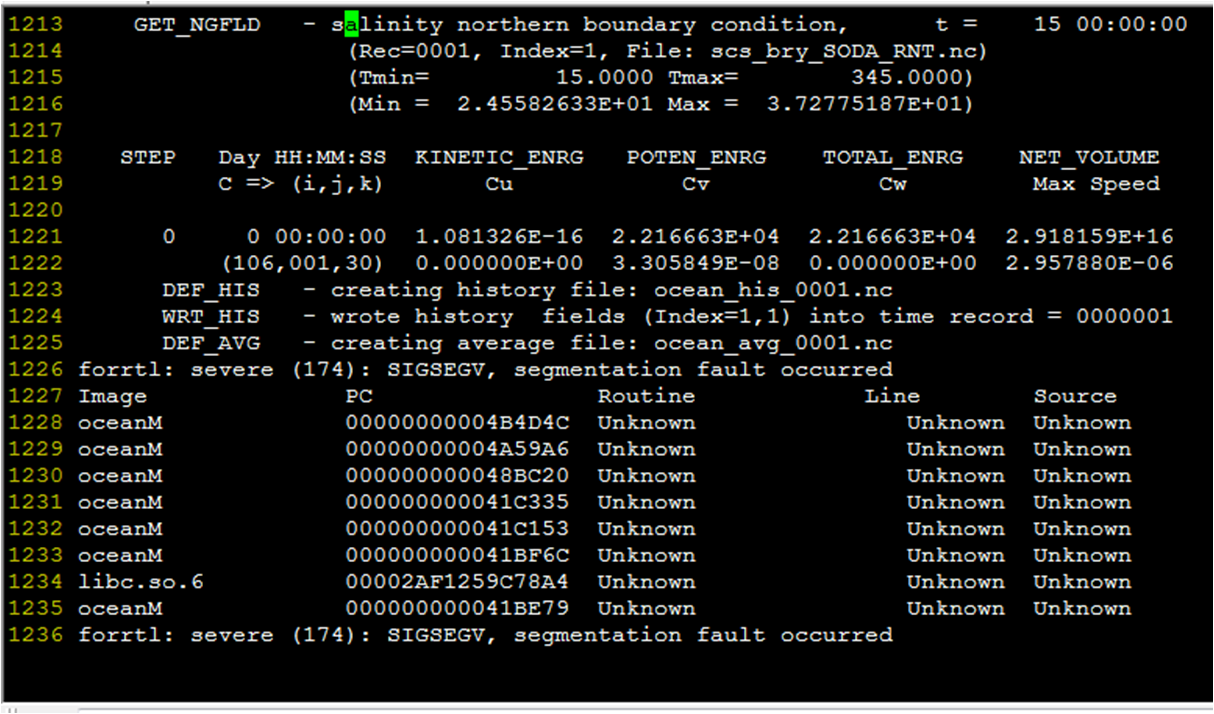

Re: unable to output time-averaged terms in the avg.nc file
Hi Kate,
By using the latest version of ROMS source, version 653, I also ran into a similar situation being not able to create the average NetCDF output file. Any comments on the potential reasons?
There's more than one way to get a seg fault. The first thing I would do is recompile with USE_DEBUG and maybe you'll get more information out than all those "Unknown" statements. The second thing I would do is run it in a debugger - debugging is relatively easy when it blows up right at the start.
Hi Kate
I have run into this before, and i do did as you suggested here, but the question is when i turn on the DEBUG the model run smoothly. So, there is nothing message can be follow. It is so tricky. What can i do if this happen again when i need the AVERAGE results.
I hate when that happens. I guess that leaves adding print statements to figure out what's going on.
