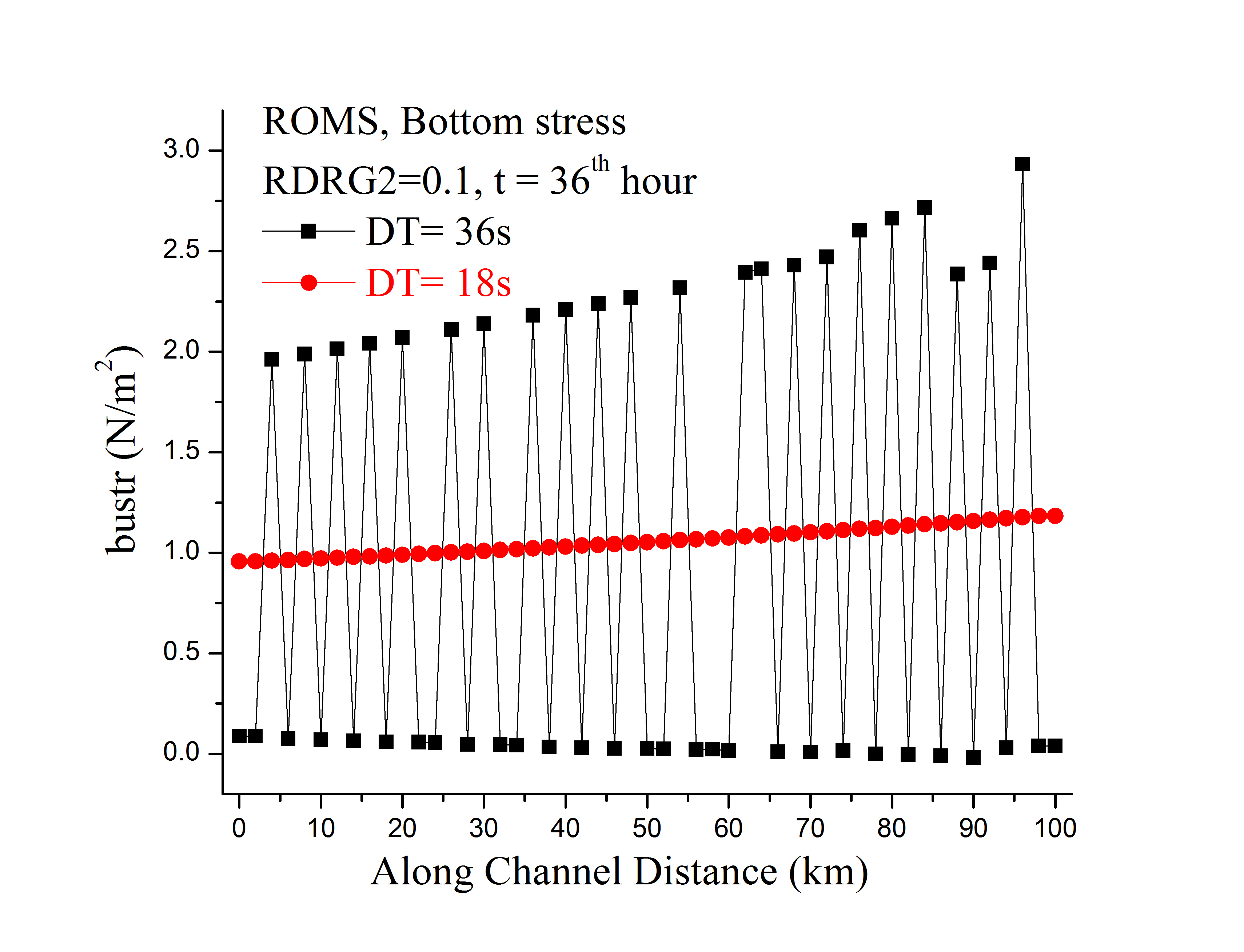

Tests show that stable results can only be obtained when a very small time step of DT = 36sec (NDTFAST == 20) is used (DX = 2km), which is much smaller than the time step limit from CFL condition. With DT = 36sec, the results of a well established stable state show pronounced spatial oscillations in bottom stresses, near bottom velocities and depth mean velocity. The oscillations disappear when DT reduces to 18sec. If DT = 24sec, the oscillations occur only near the eastern boundary where bottom shear stresses are larger.

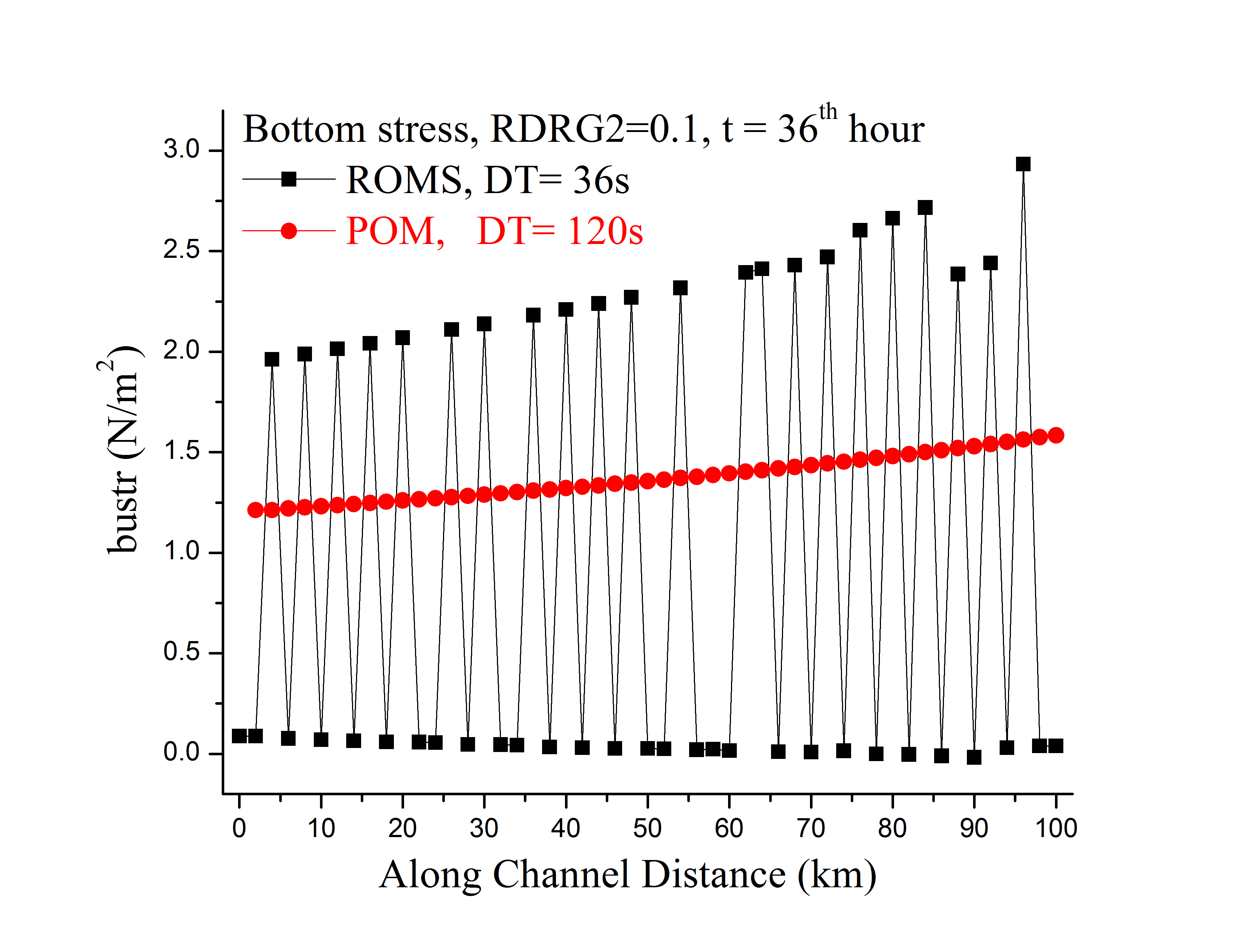

Since I have been using POM, I ran the same test with POM and found that, for this particular case, POM can predict non-oscillating bottom stress at a larger time step of DT = 120sec (The bottom stress along the center line of the channel is shown below). This makes me a bit confused as, due to the more advanced algorithms, I expected ROMS to work fine at a larger time step than POM, which I did observe in some idealized baroclinic tests where water depth is 50m and therefore bottom friction is less important. So I am thinking of two possible reasons which may cause the oscillations: (1) Inappropriate specifications in my input or header files; (2) Imperfect numerical implementation associated with bottom stress. I hope to get any help.

I noted that after uploading the header file. So I ran a case with correct spelling: #define UV_SMAGORINSKY. The results are slightly different, but the oscillations remain. I also tried different advection schemes and got a little different but still oscillating results.
I also ran a few tests in a smaller domain of 20km long with same grid numbers and got improvements. The results show no oscillations for RDRG2 = 0.1 and DT = 20s, but similar oscillations show up when RDRG2 = 0.2 (equivalent to an apparent roughness of 11cm) DT = 20s are used.
